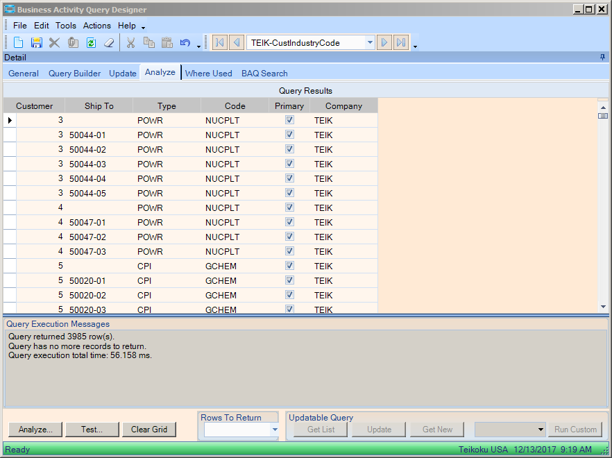

It sounds like you might want to do it as a pre processing directive… if there is one already, throw exception. The data is stored in CustIC table. It can be there for customer as well as ship to records. See sample of our data pulled via BAQ below:

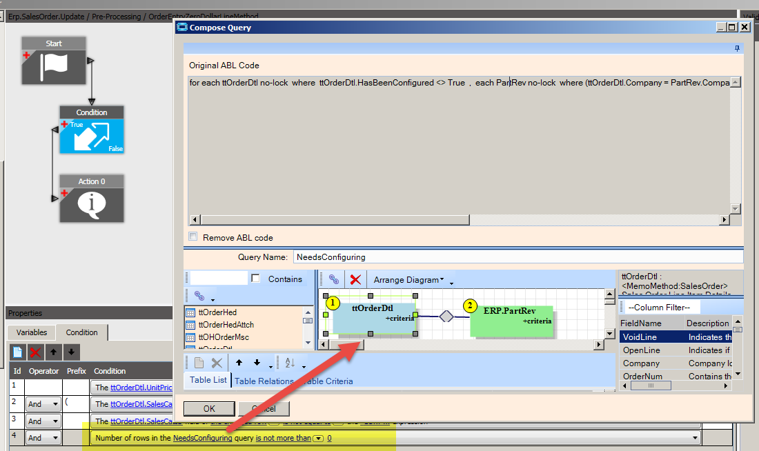

Hi Shawn,
If I were doing this, I would probably try to use a bpm on the preprocessing update of the Added record (the customer IC one) and then for a condition, use “number of rows in the … query is = 1” or something like that and then raise an exception telling user that they already have one customer ic in there and they can’t have more than one. Make sure to test that your bpm works for required edits (e.g. need to assign different ic, need to delete ic) to proceed ok too.
Here’s an example of one of our method direcitves (sales order update preprocessing) that uses a query row count condition.

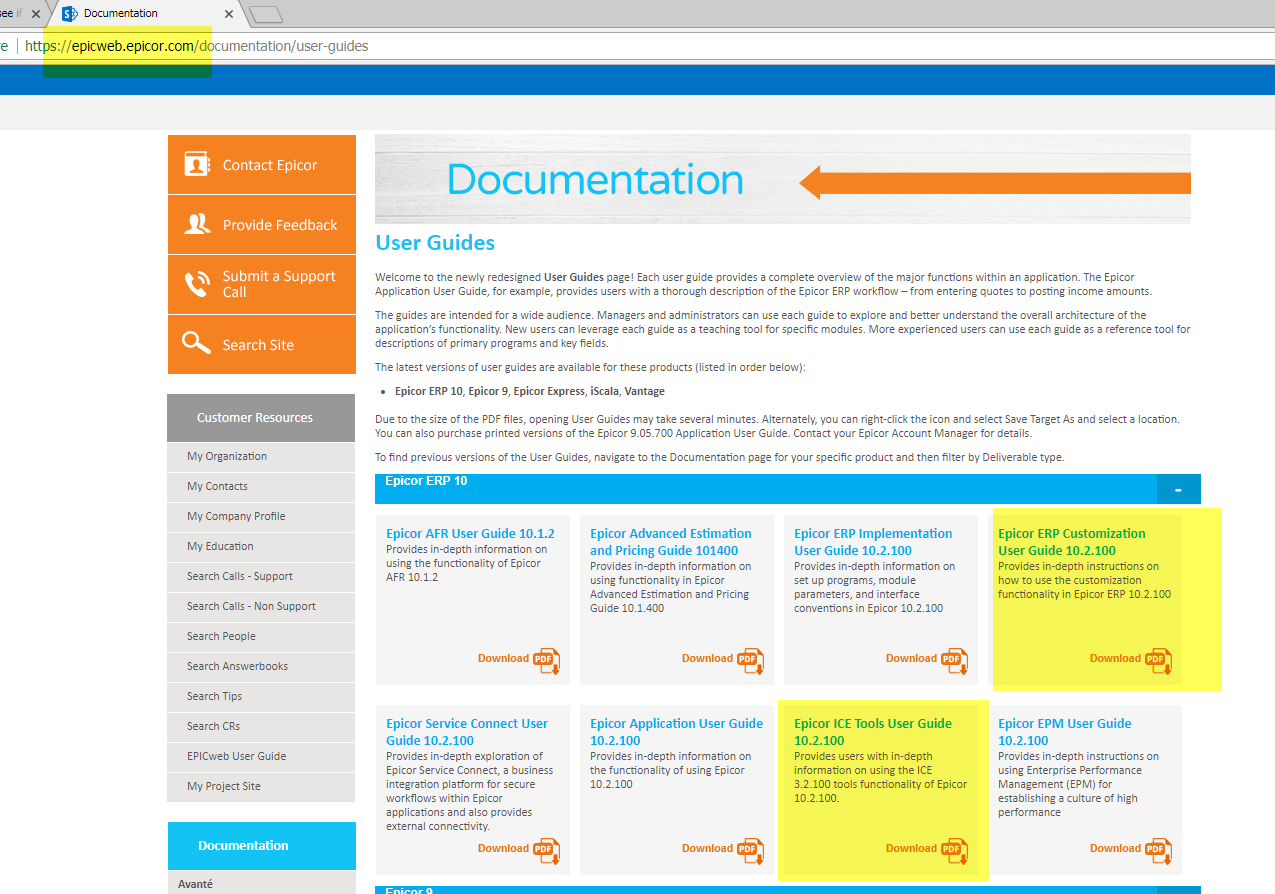

I recommend you use the ICE guide and customization guide and the posts here to try and get it going. Lots of trial and error. Need to learn to fish! :slight_smile:
