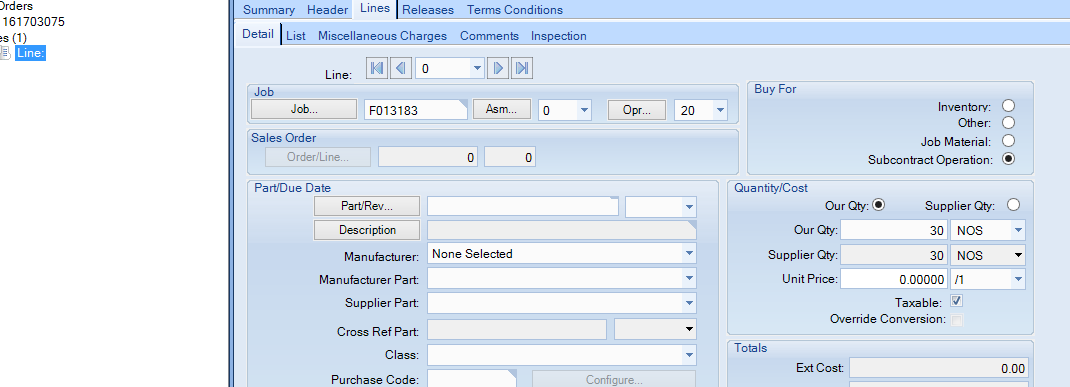

## Post #4 by @Prakash_Bankar
i have tired for both, but it doesn't retrive partnum from jobhead table..should i have change method ?
## Post #5 by @Prakash_Bankar
@Bruce, this PO is created manually, sometimes we have to create PO for outsource supplier for some operations..When i enter job number ,standard functionality should pull partnum, description. But in this case nothing happend as we expected..is there any setup ?

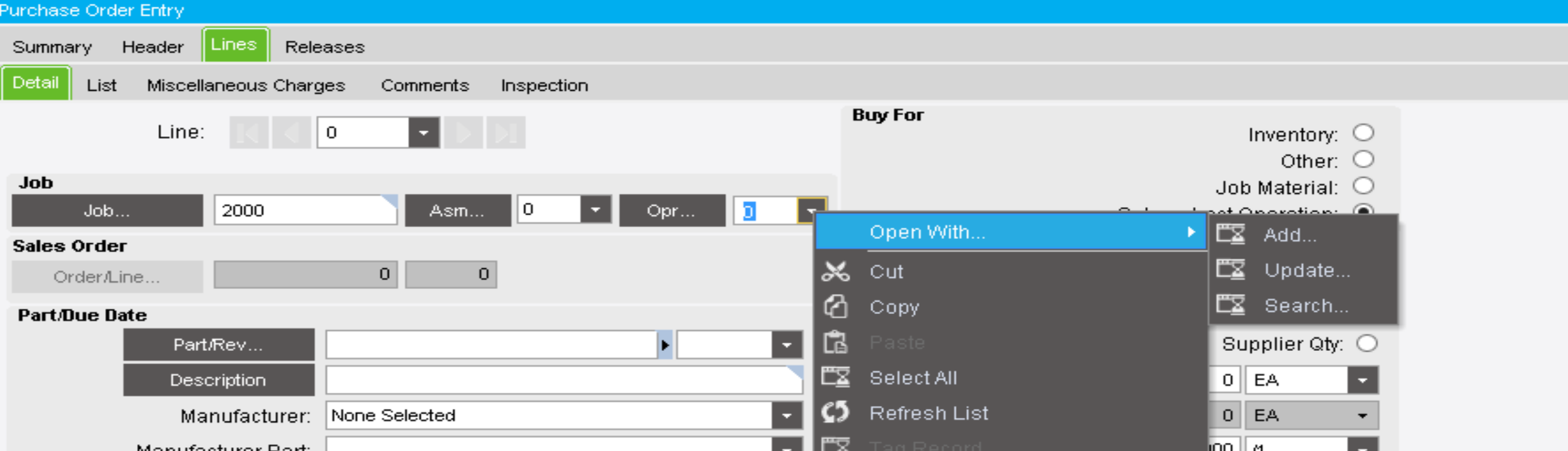

Are you creating the subcontract (not just Operation) on the job?
When you are in the PO LIne, you can create a line for subcontracting and right click in the operation and add one to the job.
## Post #7 by @Prakash_Bankar
@bruce,
Greetings ...
Actually , the subcontract operation is defined at Job entry Level, so i have to just select operation and forward it to supplier. I am not trying to ADD operation. When i have tried as u say, this screen is for adding new operation or updating existing operations. When i selects ADD , it adds new operation, in this case i already have ope 20 for subcontract,and it adds new ope 30.
My simple expectation is after job selection ,part number should be displayed in part textbox.

## Post #9 by @Prakash_Bankar
Not working standard functionality.
Now i am trying to pull data through customize code..lets see the coming picture..
