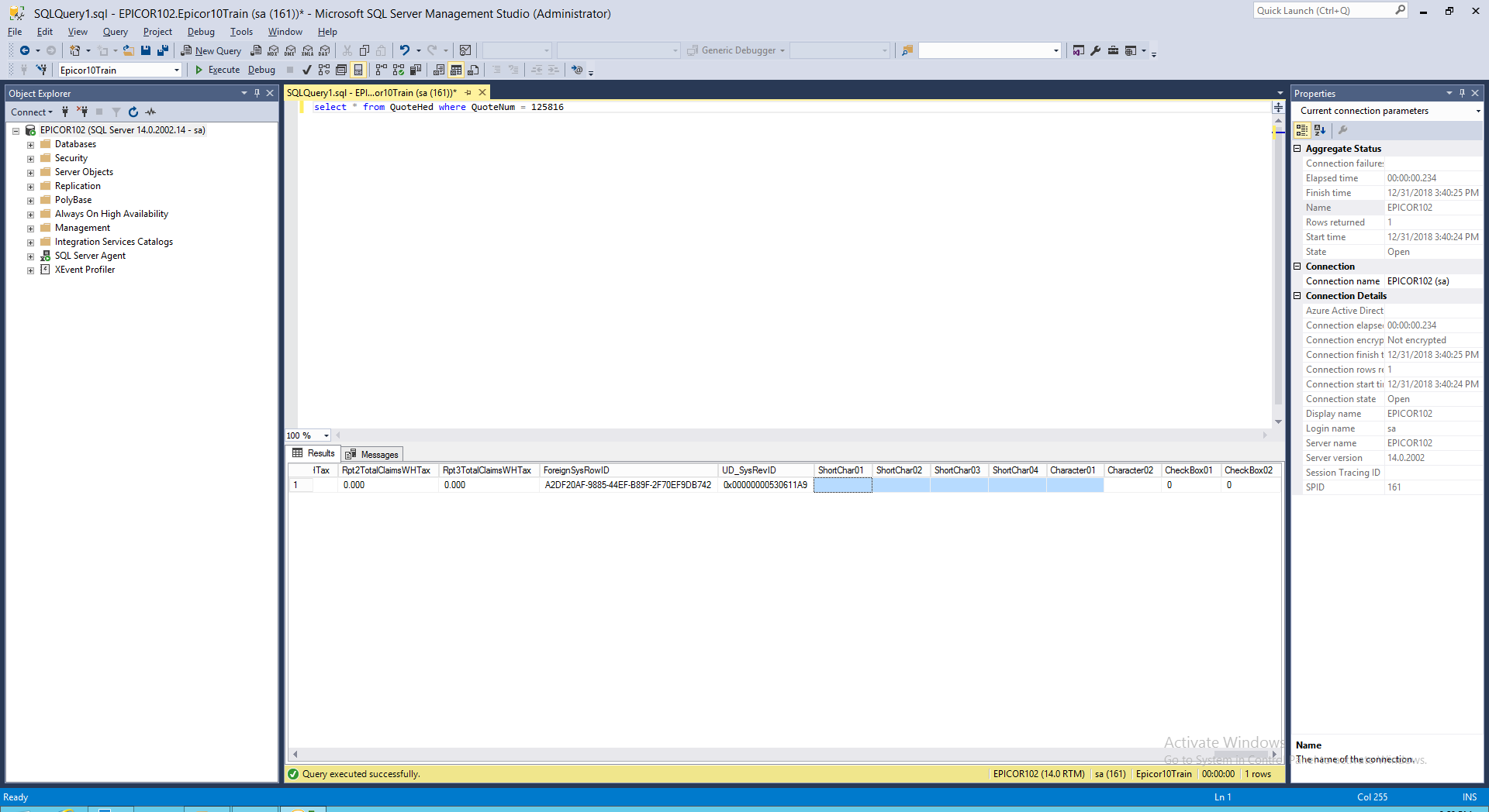

but explaind the question, i need save in the field shortchar01 of table QuoteHed, i try create a datarow of type “QuoteHedRow” and values assignated (drQuoteHed[“ShortChar01”] = “TY”) and call method “update”
but, created the new or update quote, and it is not save field extended
