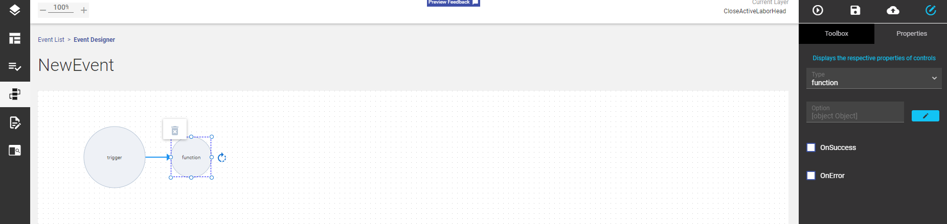

Thank you for the info. I got kinda far, but when I click on the button > behavior, there are is nothing I see that’s available to create any kind of event.
I figured out I have to click on the left hand side to events.
Then I figured out I have to click the trigger checkbox
Which drops a circle on the screen and then changes the right hand to properties which I think I have to choose some things and oh by the way I hope you remember the ID you have the button because you’ll need that. Jeesh!
Now I flip back to toolbox, I’m guessing my way through this broken tangle of bits. I see function there so I’m like okay maybe I’ll drag and drop that onto the form but dragging it to the grid does nothing. You have to actually click on function then it goes into a sub menu and then I can drag the function to the workspace!!! Wow is that super not intuitive. How hard is it to make your buttons look like buttons?! Everything about this App Studio UI is just awful. The team that made it should be ashamed of this product. Like did they do any user testing? I digress, but wow.
Anyway now that I’ve made it this far, where is the spot where I say run my user function?
Doesn’t seem like I can say run the function? Unless there is some magical non-intuitive key combination you have to perform to get it to find my function.
Oh man. See, now it just automatically makes the event and sets up the trigger with the ID etc. Well, you got there the hard way but you got there.
So, I have function and erp-function. I used erp-function.
Here I searched:
Or here I just drilled down:
But I am guessing yours is utterly different-looking.
It’s a LOT better now. Not amazing, but very usable.
