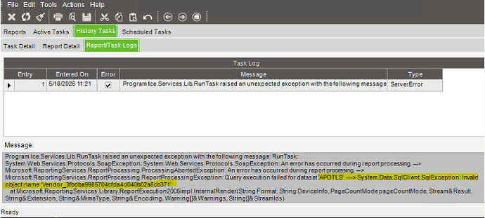

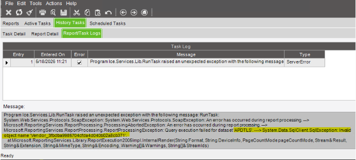

But, Still facing the following problem.
Oh you added an additional table to the RDD. No custom (UD) fields are shown in your screenshots.
Lots of help online for how to add another table to an RDD. Forum posts, Epicor KB, epicor videos, youtube videos, AI can help…
