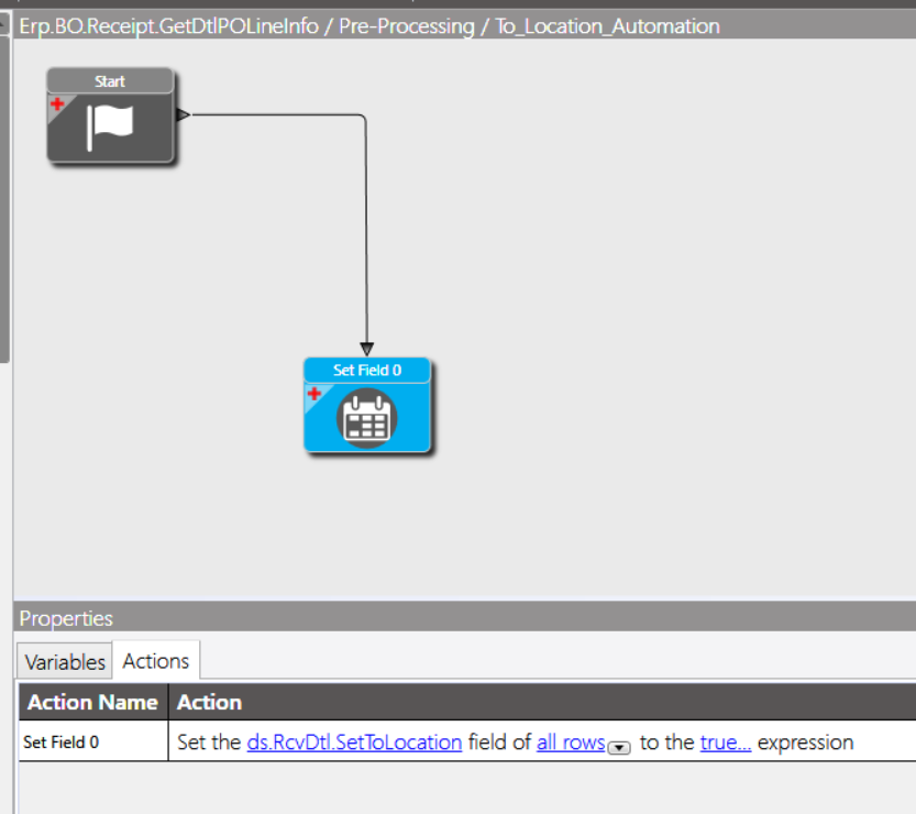

I set this up in the past for the exact same reason. At first I couldn’t get it to work, but we found that it was because of parts not having Primary warehouse and Bins set up.
Solution ^^^
