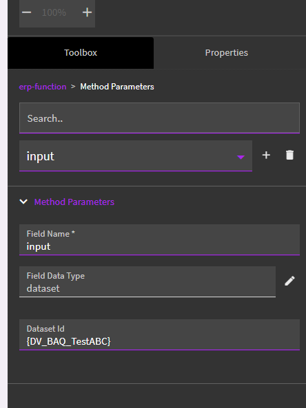

Aren’t the results a dataview? Just pass it to the function as a dataset then process it.
Here is an example

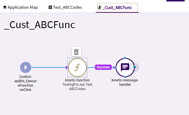

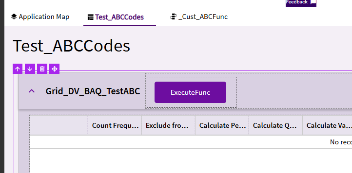

Created a BAQ and a dashboard, adding a button

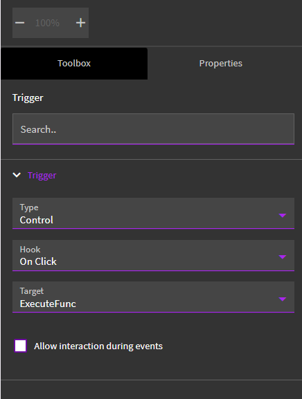

Created an event for a button click
Setup the trigger
Setup the function request parameters

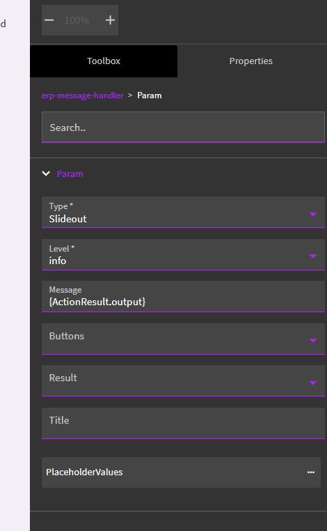

Added a message handler to display the output results in the function

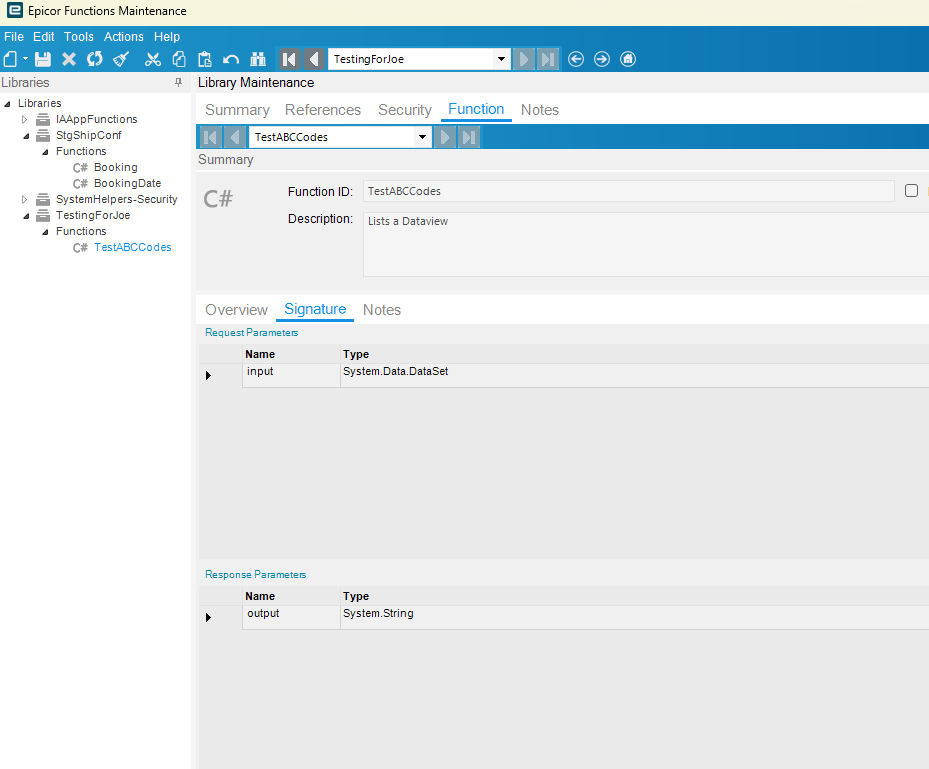

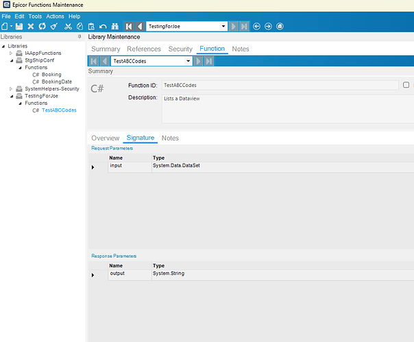

Function Signature
Code snippet

This was done on 2025.2
Hope that helps.
