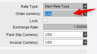

I have a sales order that has the wrong currency set and the field is greyed out. How do I change the Order Currency? Not sure how this happened as the customer is setup for USD currency.

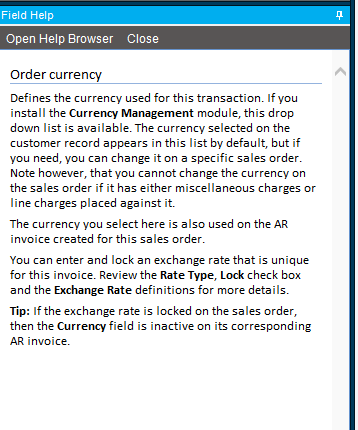

Do you have the “Currency Management” module? Also, has there been any invoices against it?
Delete all the lines on the order, change the currency and add the lines back again
That worked. Thanks
