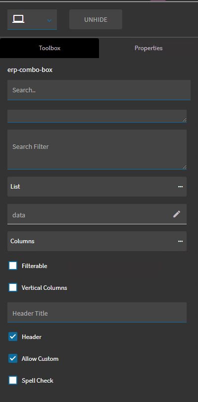

In ur combo box properties the before last option in the advanced settings is “Allow Custom” and check that box you will be able to delete the value that is entered in the combox.
Not sure why its built like that.
Hope that helps!
