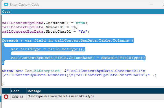

I thought I had it with this:
foreach ( var field in callContextBpmData.Table.Columns )
    var fieldType = field.GetType();
    callContextBpmData[field.ColumnName] = default(fieldType);
but it doesn’t like me putting a variable where a type should go, even though the variable is a System.Type, dangit.
