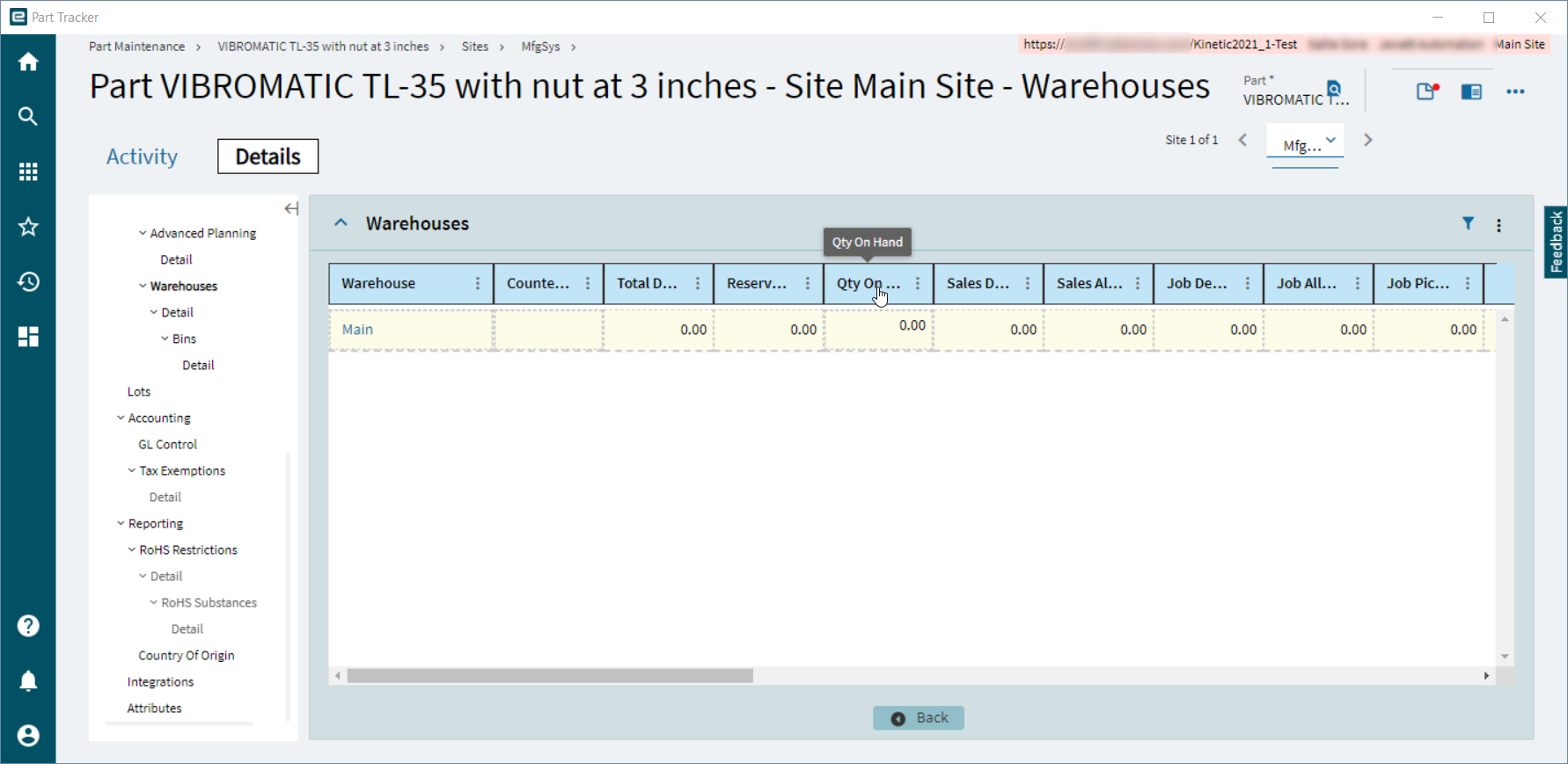

also on Part tracker look at the On hand tab > Warehouse do you see a quantity in Total Demand

OK, so I see the parts I entered under Tracker (but I guess because its a part) but when I go under a part, under Warehouse, I find qty on Hand is 0

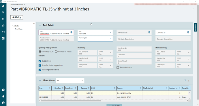

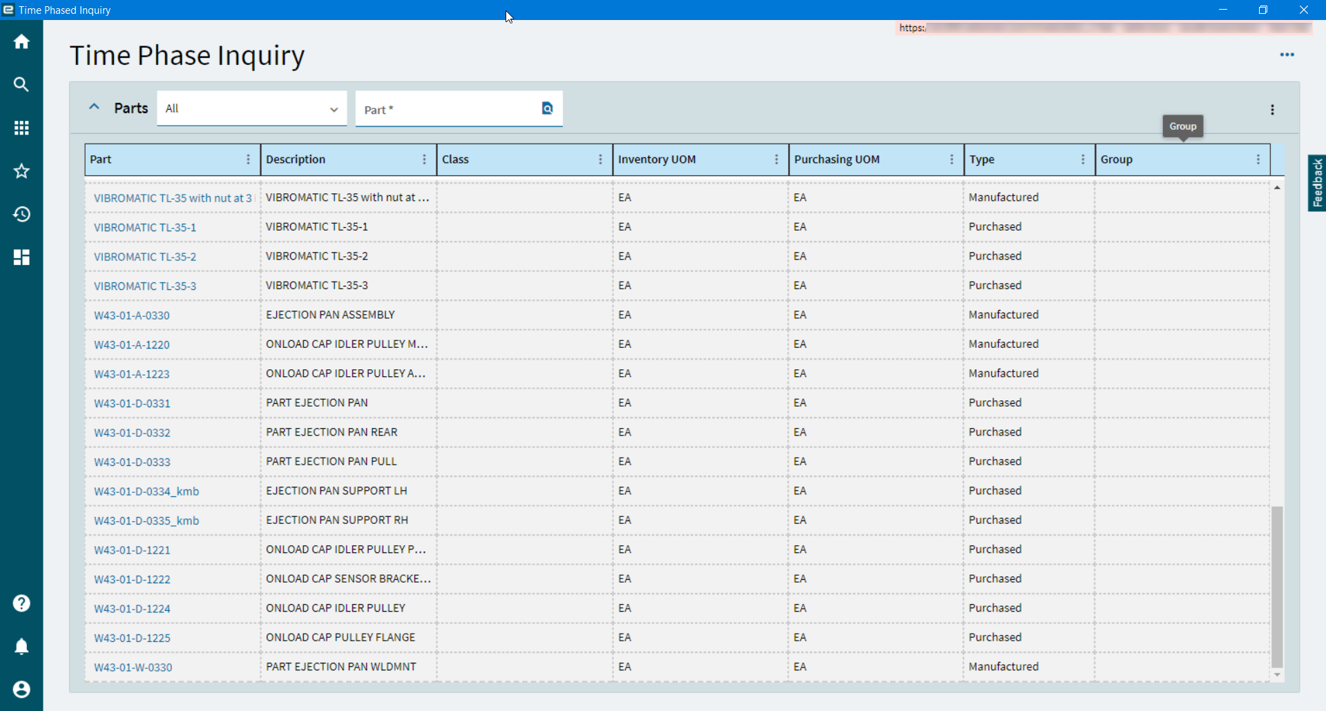

However, I do see the part in Time Phased Inquiry, is this showing all the parts, or demand?

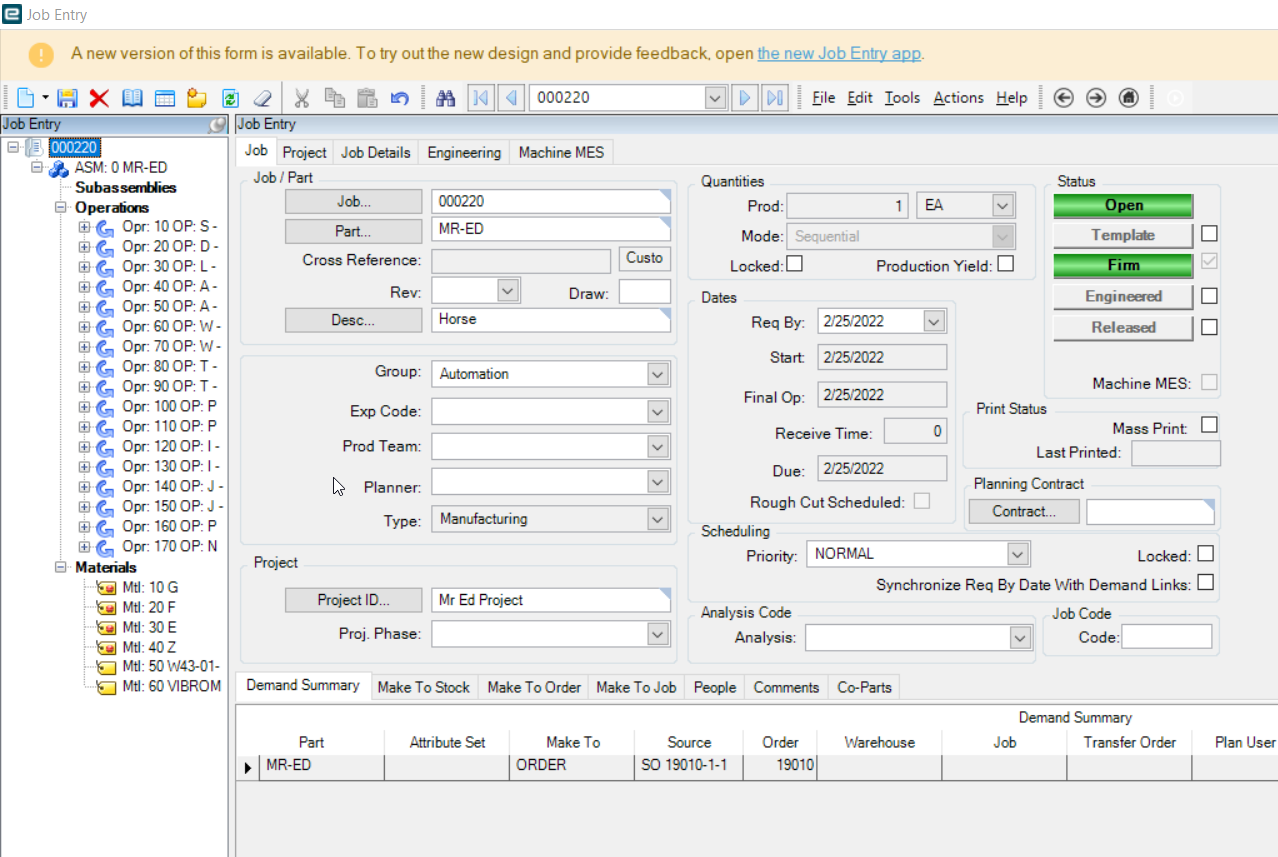

Did you add those parts after the job was scheduled? Based on the red dot that isn’t there, it looks like there isn’t a required by date on that line. Please look in time phase for that part, find the line from that job and verify that there is a due date on it.
Also, the job isn’t released. I don’t think you’ll get any demand until the job is released.
no, we did not add that when the original job was created/schedule as when the quote comes in, we don’t know what will be in. We design the machine from scratch working from the ground level with their needs till the end to then design the part, then we order the part. I am thinking we will need several jobs in the project. Perhaps the project is not built well for our scenario?
this is one of the main issues we have had with the contractors, we don’t do cookie cutter, everything is custom and we don’t really have anything boxed and ready to go. As for your question of released, it was released previously, and engineered, but I changed that during the testing, we have had several hundred testing projects.

Can you PLEASE open up time phase and send a screen shot of it? I will tell you what the problem is if you do that.
sure any place in particular, we have a lot of stuff there
The part that you think should have demand… Looks like the first one on the list.
Yes, from what we understand
