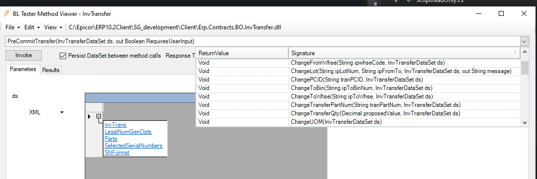

There are a lot more methods that are called in that transaction that you are skipping. There’s one for change to bin, change from bin, change part number, change to whse etc.
Do a trace, from when you load the part number, to when you hit the transfer button and make all of the those calls and it can work. (I have done it). Use the business objects to make sure that get it right.
