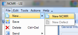

Dan - Thanks for the link. It was very informative and it got me pointed in the right direction. I was able to figure out how to do this after reading through that article and doing a little investigation on my own. Since the New tool had a drop down, I had to figure out how to access it’s children and change the .SharedProps.Caption property for both of the children. Here’s the final code:
// This method is called when the form is first loaded
private void UD101Form_Load(object sender, EventArgs args)
    PopupMenuTool newMenuTool = (PopupMenuTool)baseToolbarsManager.Tools["NewMenuTool"];
    newMenuTool.SharedProps.Caption = "New NCMR";  // This set the tooltip when the mouse hovers over the New button
    newMenuTool.Tools["EpiAddNewnewParent"].SharedProps.Caption = "New NCMR";  // This changes New Parent to New NCMR
    newMenuTool.Tools["EpiAddNewnewChild"].SharedProps.Caption = "New Defect";  // This changes New Child to New Defect
And here’s the result:
image image
