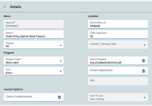

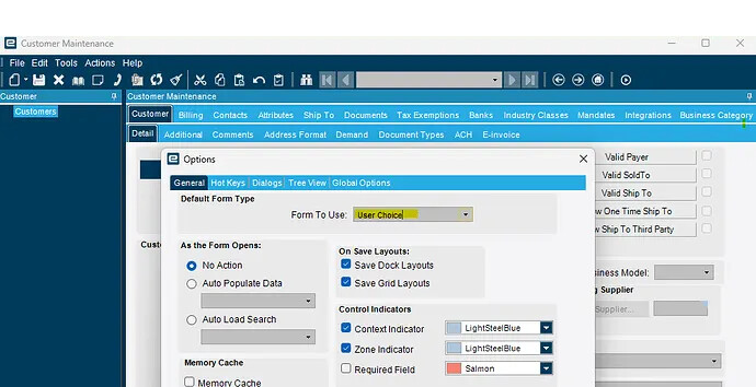

You have the form to use on menu maintenance.
Part of it will depend on if your menu items have the classic forms added. Which will depend on when you started using the software.
Often the easiest way is to set up the Edge Agent pointing to the client. Then in the browser right click the menu item you want and go Developer > Open in classic. Give it a small while and it will open the classic screen for you.
I created independent menus for some Classic forms:
I make sure they are “Menu Items” NOT “Kinetic Apps” and don’t provide the Kinetic Application bit.
Seems to work for me. Although, I set these up a good while ago.
