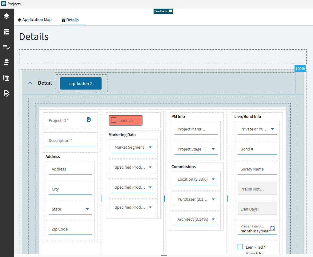

I added an erp-button in application studio on the project detail tab and want to fire a method bpm when it is clicked. What is the easiest way to do this. See screen shot below.

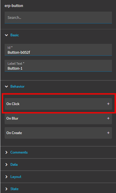

In the properties of that button, in the Behavior section you can select On Click. It will create an event and open up a new tab that takes you to the new event. Then you have to setup the event.
