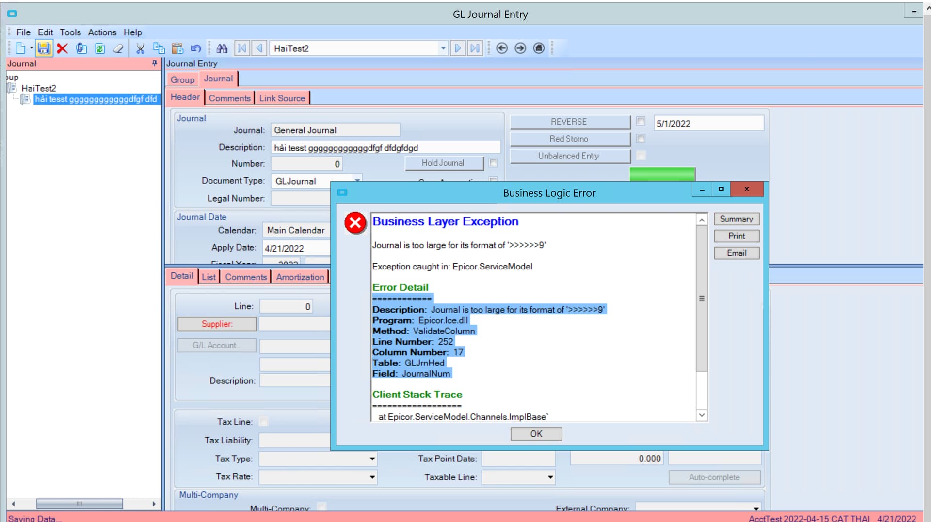

How to fix GLJrnHed Msg: Journal is too large for its format of '>>>>>>9'
I get this error when DMT or create new GLJrnHed
SDDK Opening Balance Table: GLJrnHed Msg: Journal is too large for its format of ‘>>>>>>9’
JournalNum is an integer value in Epicor, Try to add an integer value.
When creating a new number, this number is automatically generated, there is no place to enter it
The error was caused by someone affecting the GLJournalNum of GLJrnHed, so it was necessary to update the CurrentValue to be able to add a new GLJrnHed
select * from  erp.GLSequence where key1='01 '
update  erp.GLSequence set  CurrentValue=5000000 where key1=01 and Key3='GJ' and Key4='2022'
