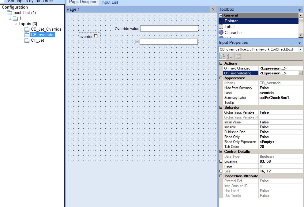

OK, managed to get the If/then statement to run:
if (Inputs.CB\_override.Value = true)
Inputs.CH\_Jet.Value = Inputs.CB\_Jet\_Override.Value;
else
Inputs.CH\_Jet.Value = “4”;
this is in the ‘On Field changed’ action (I tried in it the ‘On field validating’ , and it crashes Epicor!)
now, while it does allow me to enter the string from CB\_Override.Value, it will only grab it when I hit the check box. But the check box doesn’t turn on or off, it only seems to dump the value of CB\_Override into CH\_Jet.
I feel I ether am missing something to revert back, or the if/then statement is missing something to continuously check if CB\_Override is true or false… I kinda feel there needs to be a ‘page refresh’ in the on field validating of both the CB\_Override & CB\_Jet\_Override. But am baffled how ask for this…

CB\_Override
On Field Changed:
if (Inputs.CB\_Override.Value == true)
Inputs.CH\_JetInstalled.Value = Inputs.CH\_Override\_Jet\_Install.Value;
Inputs.CH\_JetSpare.Value = Inputs.CH\_Override\_Jet\_Spare.Value;
Inputs.CH\_Override\_Jet\_Install.Invisible = false;
Inputs.CH\_Override\_Jet\_Spare.Invisible = false;
else
Inputs.CH\_Override\_Jet\_Install.Invisible = true;
Inputs.CH\_Override\_Jet\_Spare.Invisible = true;
Inputs.CO\_Elevation.Value = “”;
Inputs.CO\_GasType.Value = “”;
But sadly, while I seemed to have solved this, a new problem has arisen… ☹ completely unrelated…
