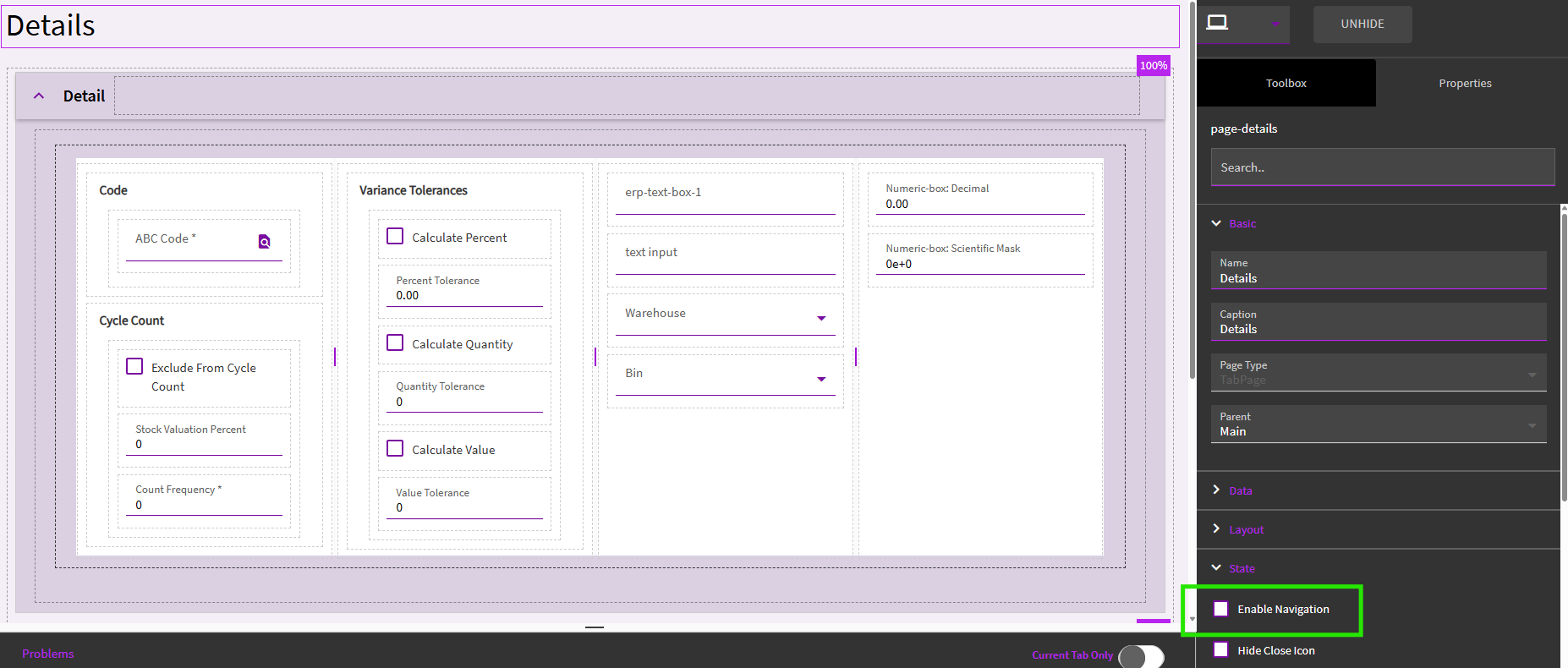

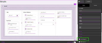

Navigation is checked:

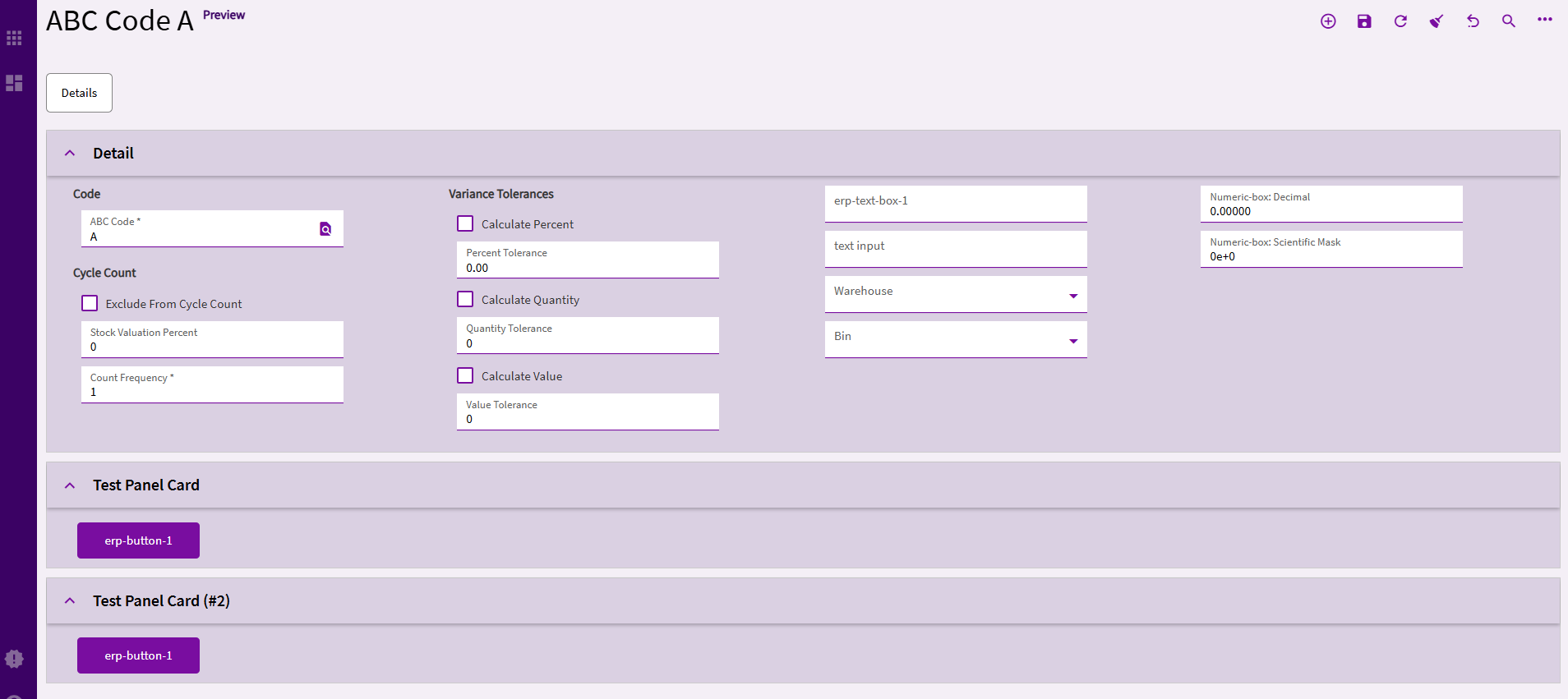

Example: ABC Code, of course.

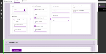

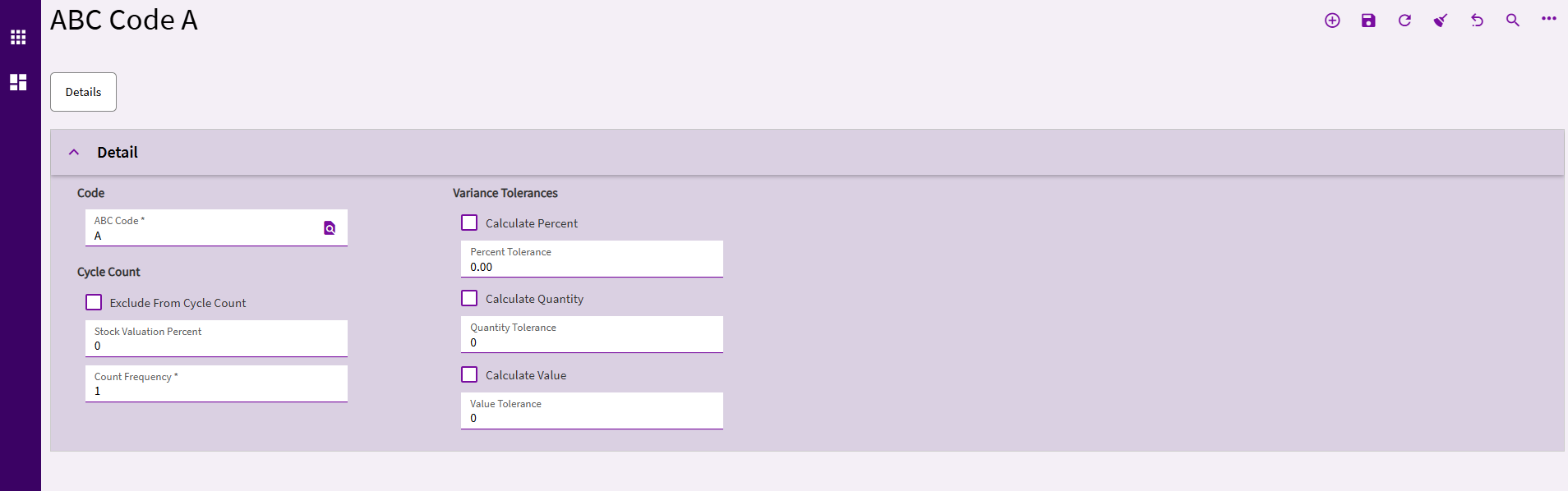

Stock application… NO left-hand navigation pane.
Note: Enable Navigation is unchecked… i think this feature is tied more to the breadcrumb bar than it is to triggering the left-hand pane.

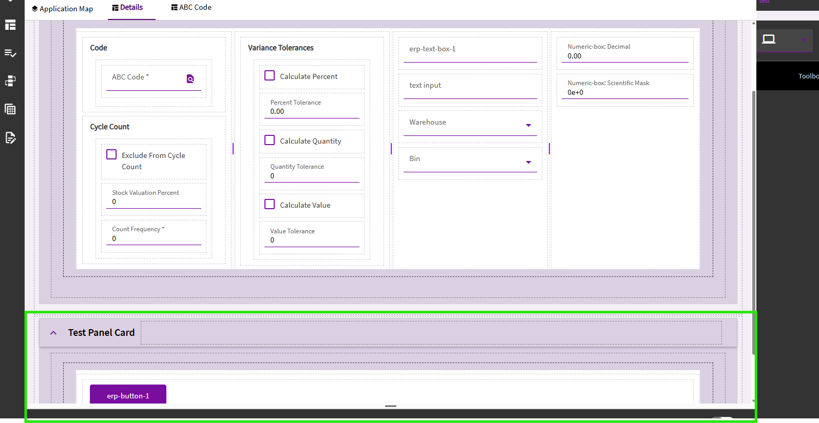

If I add a Panel Card…
No Left-hand Pane:

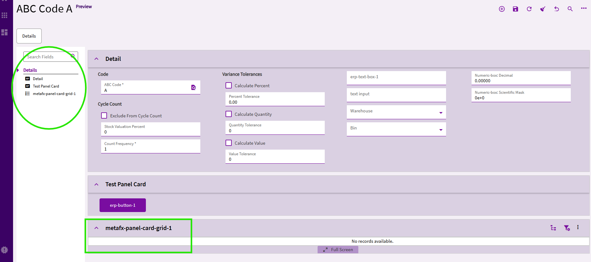

If I add a second panel card… same results:

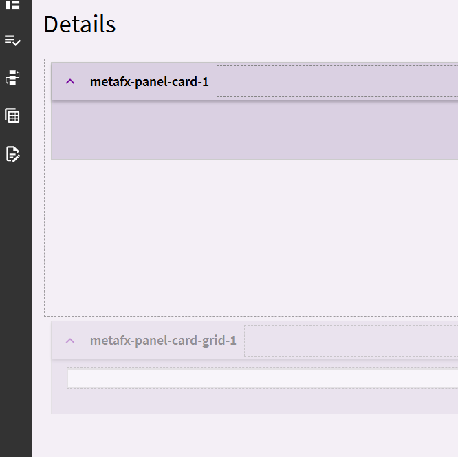

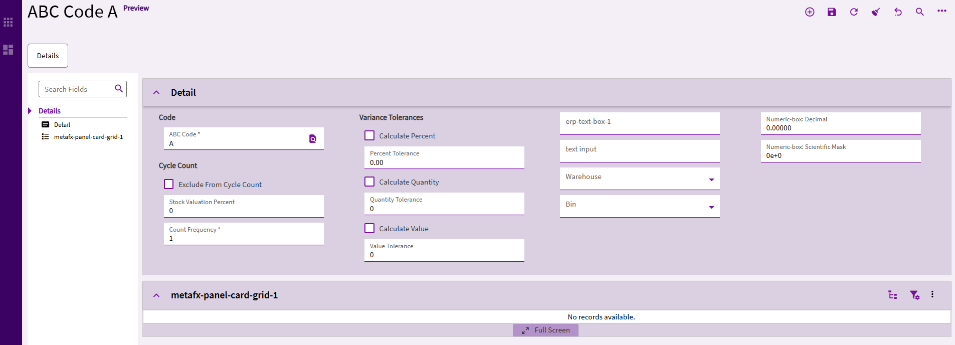

But, if I get rid of that second panel card and add a panel card GRID instead… BINGO!
I can even remove the initial added panel card and the navigation remains:

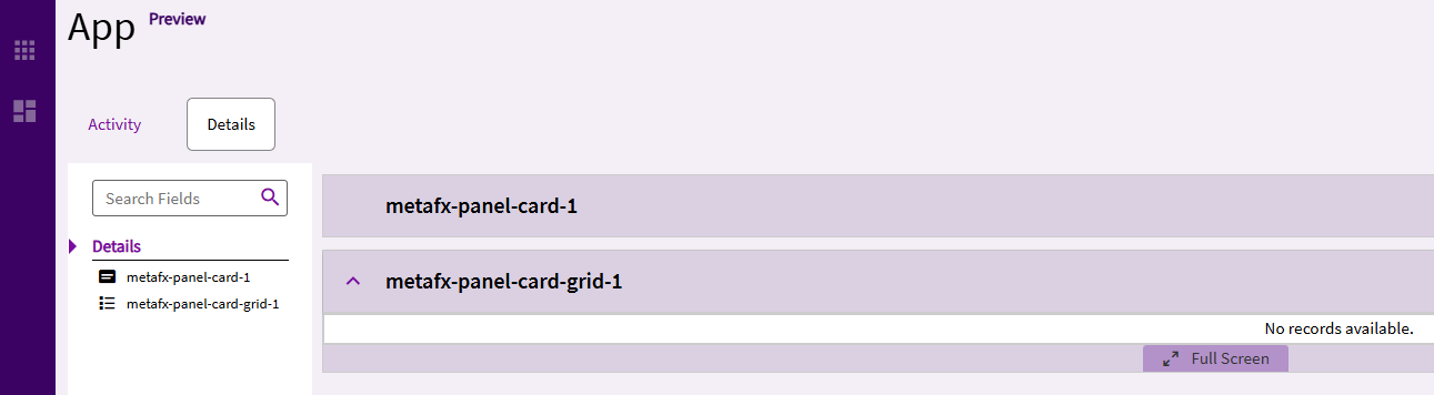

BUT… in a test APP…
Adding a Panel Card… nada:
Adding just a panel card GRID… yahtzee!

best bet may be to add a pcGrid to force the left-hand pane, but set it to not expand at runtime, and set it to disabled so the user can’t interact with it. A pain, but… works:
