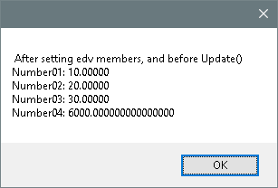

I’ve added a bunch of message boxes for debugging, and can see the values of the edv members at various stages.
Here it is right before calling oTrans.Update();
And here it is right after
Number04 returns to the value it was when the record was loaded.

		message =" After setting edv members, and before Update()\n";
		message += "Number01: " + edv.dataView[edv.Row]["Number01"].ToString() + "\n";
		message += "Number02: " + edv.dataView[edv.Row]["Number02"].ToString() + "\n";
		message += "Number03: " + edv.dataView[edv.Row]["Number03"].ToString() + "\n";
		message += "Number04: " + edv.dataView[edv.Row]["Number04"].ToString() + "\n";
		message += "RowMod: " + edv.dataView[edv.Row]["RowMod"];
		MessageBox.Show(message);
