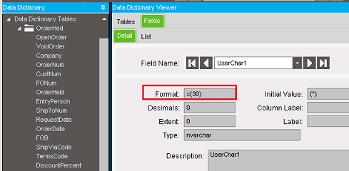

Having a little brain stumble this morning. I am needing to increase the OrderHed.UserChar1 x(30) to x(100).

i.e. any fields that show up in the data dictionary viewer?

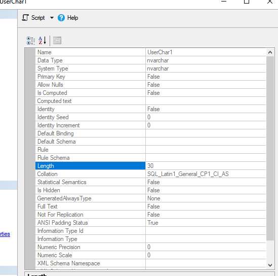

Sometimes some fields are only limited to a certain length on the UI but not SQL. In this case UserChar1 is limited to 30 in SQL so using something like Extended Properties Maintenance wouldn’t work.
