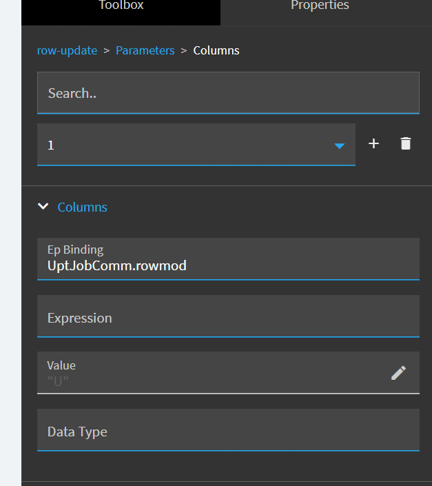

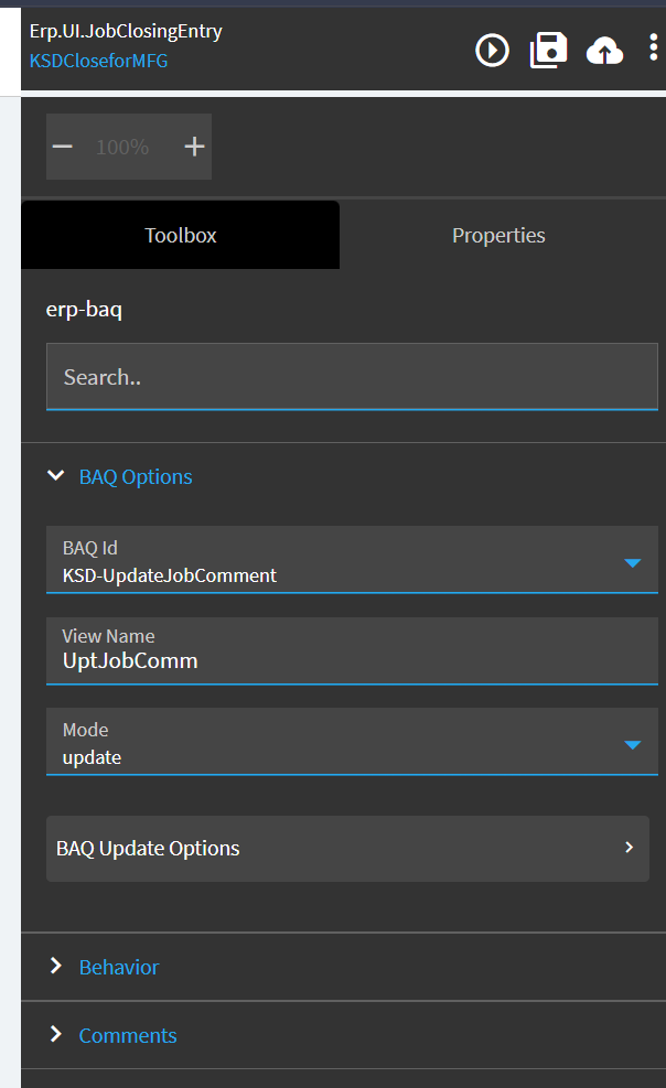

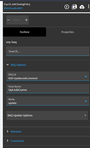

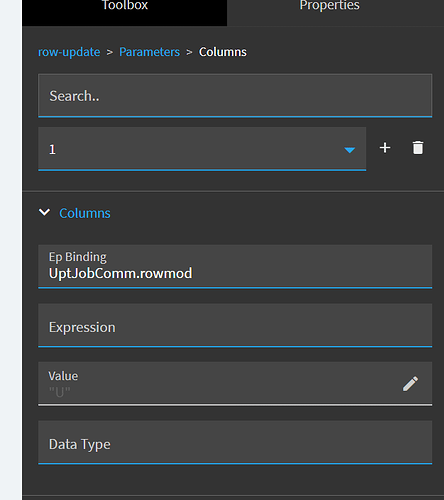

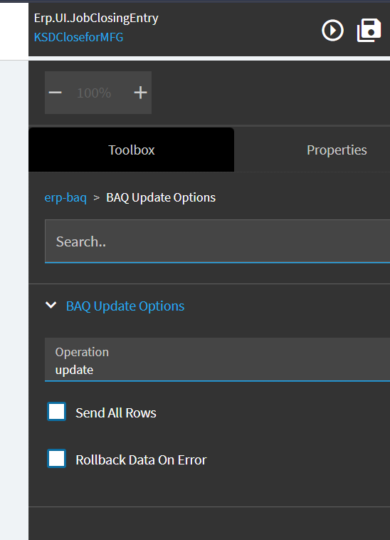

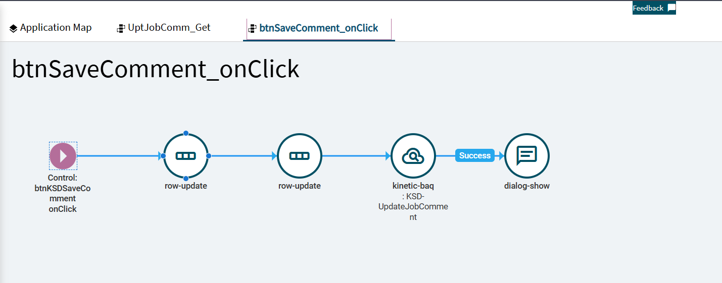

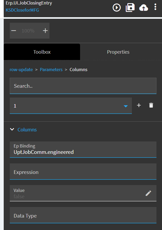

I got it working finally. The rowmod was the key, but also I was able to send a jobhead.engineered = false which allowed me to save but because that’s not an eligible field for updating in the BAQ leaves the status alone on the jobhead record.
For future me (and anyone else that may find this useful)
First row-update
Second row-update
