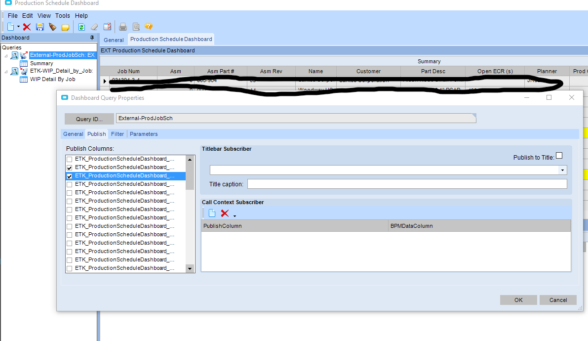

I have a Dashboard that was requested and I’m using 2 BAQ’s to in the same dashboard to do it. The top BAQ is for Job material information and the bottom BAQ is for Job Operation information. I want to make it so if I select 1 row from the top BAQ and its for JOB 1234 then the bottom baq populates for the same Job 1234. I’m not sure how to go about this any help is appreciated.

On the top query
Right click the properties.
On the publish tab select the field you want the bottom query to use.
On the bottom query
On the filter tab. Filter the field on the published field from above.
