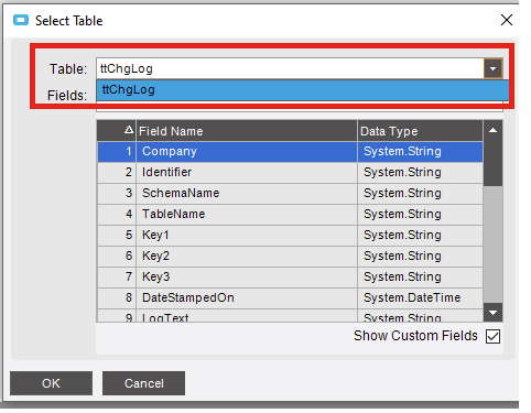

How many fields you need to supply an email if a change occur? If it is a lot, maybe a simpler solution would be to activate the changelog in Part DD, for all the fields you need to catch. Then add a DD for the ChgLog table, add a condition widget if TableName=‘Part’ just send a general email that a change has happened), and you can add the change log details LogText into the email…
So you create a in-transaction directive with the condition that TableName=“PART”. and add the widget to call a standard one (because that is where the email widget is…).
Then the condition of the standard one is to be called by the in-transaction “testPierre”

I didn’t noticed that there are two similar tables of change log which are ChangeLog and ChgLog that is why I’m confused where you took the Key1 and LogText fields because I used the ChangeLog table instead of the ChgLog . Now I’m trying to use the ChgLog table and hope it works.
