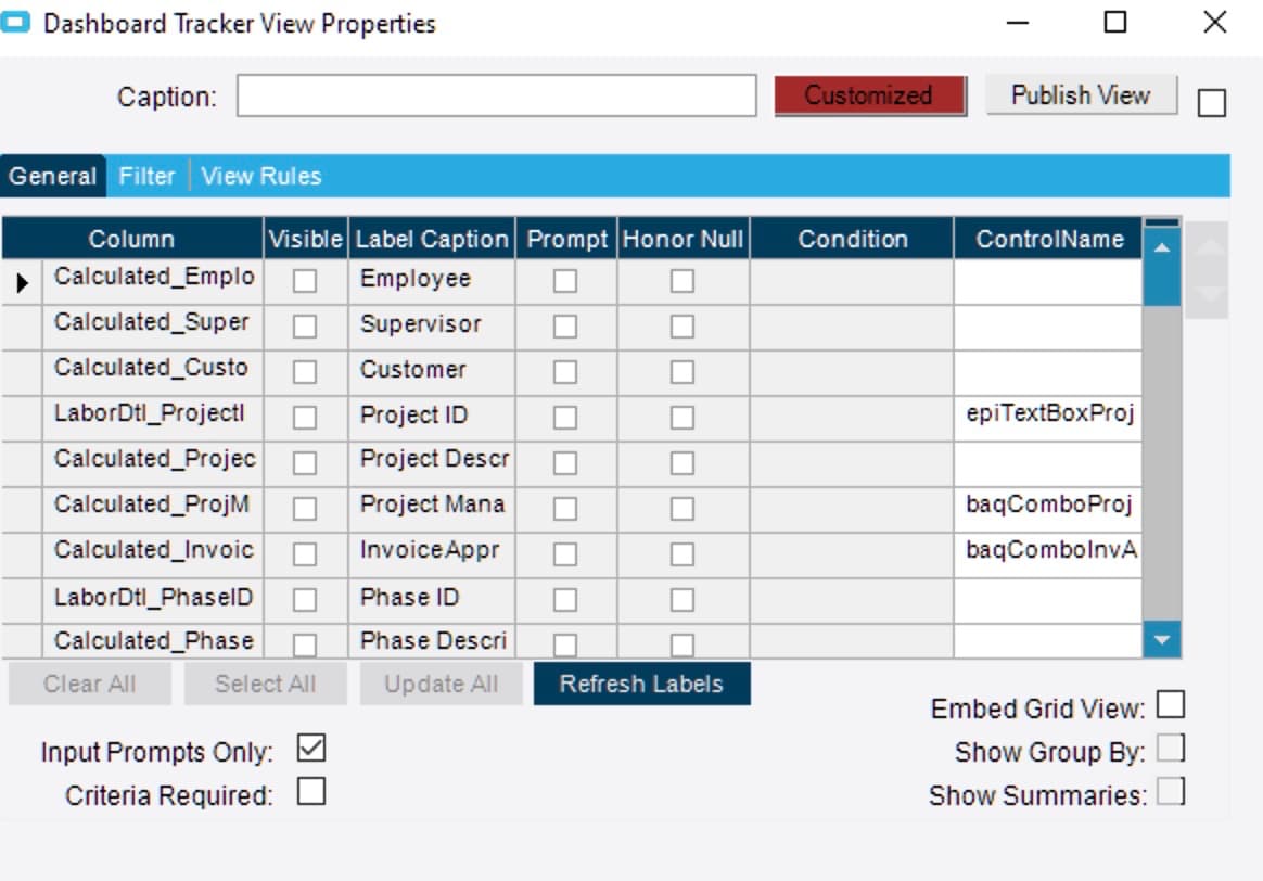

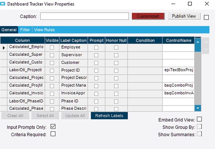

Thank you for your answer. In my case, the Inputs Prompts is not enabled, do you know why ?
Please ignore ma question, i found what is wrong. I give it a try. Thank you
I’m not entirely sure what causes that to be disabled or enabled, I’ve run into it before. We almost always customize the tracker view, and I’ve learned to always check that box first, then do the customize.

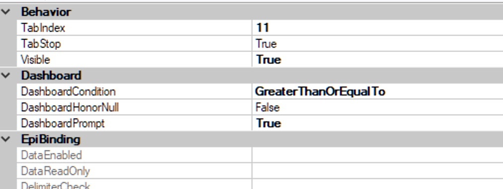

I think you can achieve the same results by setting each field (if you customize the tracker view) by setting the property for DashboardPrompt to True for all the fields. (something else we always do)
