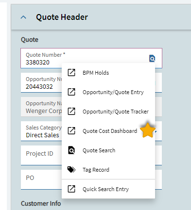

I have a dashboard that I want to open from a context menu in quote entry. I have a context menu setup in Context Menu Maintenance for QuoteHed.QuoteNum and when I use the context menu, the dashboard does open like I need it to. However, I’d like to pass the quote number as an LFO. Any thoughts on how to accomplish this?

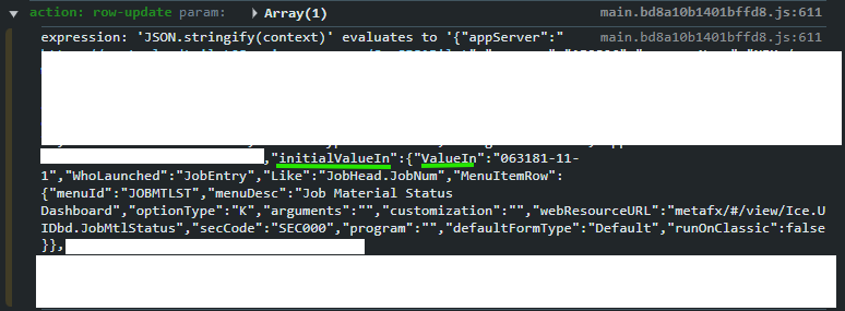

In my example, I’m right-clicking a job number and it automatically sends the JobHead.JobNum value to my dashboard.
So, in the published dashboard, when I use the open-with context menu, I can see the actual structure (and value) coming in.
So… this tells me I need context.initialValueIn.ValueIn
So… I then go back to my dashboard in App Studio… and I can use that expression:
Save and Publish that change… then test my context menu again.

Definitely a lot cleaner to look at. Preview mode still doesn’t provide the ValueIn portion. You still have to publish and send it a real value in order to see the settings.
