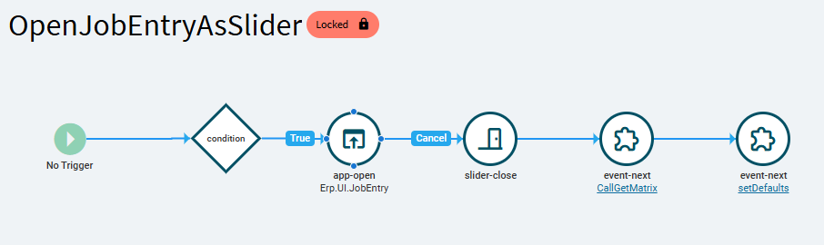

I don’t know if this is the only place this appears (by the naming convention, it appears it might be), but there is an event in Job Manager called OpenJobEntryAsSlider.
The app-open widget opens Job Entry as a slider - in your customized layer, you can copy this event, change the trigger to override the original event, and change the properties of the app-open widget to use your customized layer(s) on Job Entry.

I have copied the OpenJobEntryAsSlider and pointed the App-Open to the job entry customization. How do I trigger this to override the original event?
I found the Event with Hook Override that let me target the customization. In testing it looks like it worked. Moving on to LIVE now.
