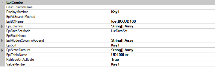

I have a UD101/UD101a set of data… I want to put two combo boxes on the Part table
Field 1: Combo populated from UD100
Field 2: Combo populated from UD100a.ChildKey1 filtered on UD100.Key1 value entered above.
Anyone know how to do this?
EXTRA CREDIT:
Would love to allow user to optionally choose from Field 2 first, which would auto populate the value from UD100.Key1
Just on the fly here… hopefully someone has a more solid solution. I did this like 7 years ago and haven’t revisited it since. It was laying around still in VB.net but i ran it through telerik (so watch for parens where there should be brackets) to help make it a bit more readable. I had this in place back in Vantage 8, and it worked perfectly. You may have to tweak this since i haven’t shook it out in C# but your answer lies within. Like most of us, so many things I’d do differently but conceptually this works.
