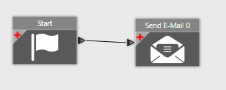

It is a BAQ reports with a few options fields. I am not doing a beak in the routing because if i do it will send one email for each record and I don’t want that. The condition block requires a break.
@cbastijanic, Can you share your routing rule and workflow to check the possibility to remove blank reports?
There is no break.

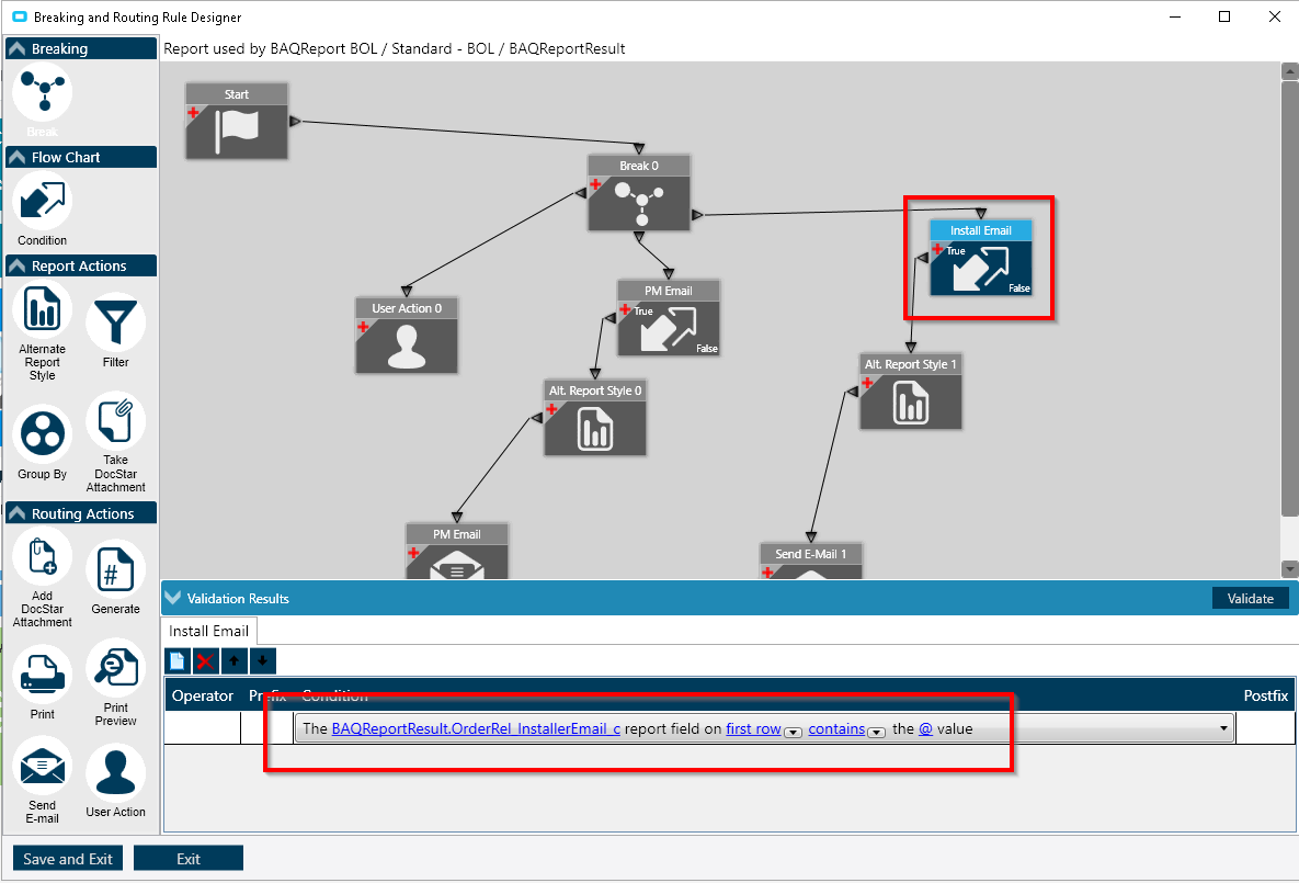

I check to see if I have a valid Email address before sending the email. If no report is sent.
What are you breaking on
In this report I break on the ShipHead.PackNum.
