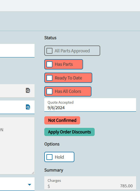

This would be related to when you PRINT or PREVIEW an Order, Epicor automatically “confirms” the order and removes the “Not Confirmed” tag from the Order page (below status on the order page), essentially acknowledging the order.
Here is the “Not confirmed” tag on the order screen (some of the other check-boxes are not standard and ours, internally).

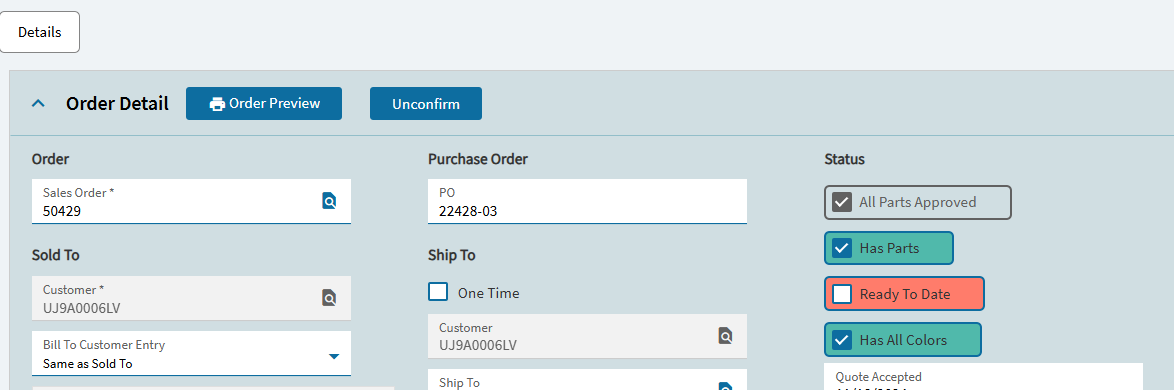

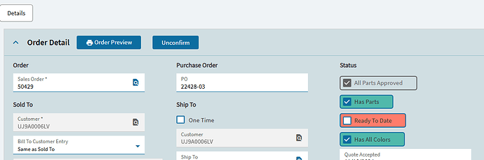

Here is how we solved this and added a feature that allows us to UNCONFIRM an order acknowledgment:
  1. We created a button specifically for the “Order Preview”
  2. The button pulls from the “Print Pro-Forma” Option in the Order
  3. Created a Custom SRSS Report that is exactly the same as our regular order acknowledgment (Print-Preview) so that the Order Preview is the same
  4. Our developer put an uncofirm order button in so that if one of our specialists accidentally print-previews an order, we can reset the order to “uncofirmed.”
… and voila! :slight_smile: Cheers.
