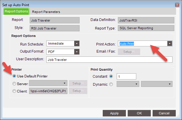

Have you considered a data directive (Standard) not transactional.
