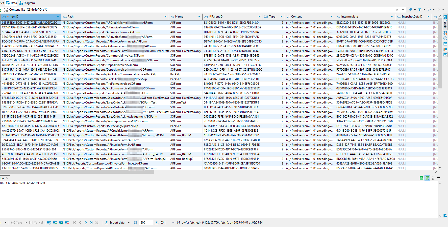

I don’t know what you could do if you’re on Cloud, but if you’re On-Prem and have access to your SQL server, you might be able to query the SSRS database, e.g.:
    select * from ReportServer.dbo.Catalog where Content like '%ShipToPO_c%'
That’ll at least get you a list of RDL files that include that field in their SQL query. From there you’d have to figure out where the field is actually being used and convert things to the appropriate type.

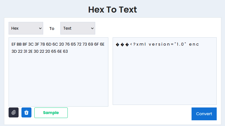

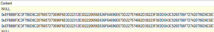

Looks like they moved it from XML into a hash at some point.
No, I’m pretty sure that’s just the hex representation of the binary data… :smile:

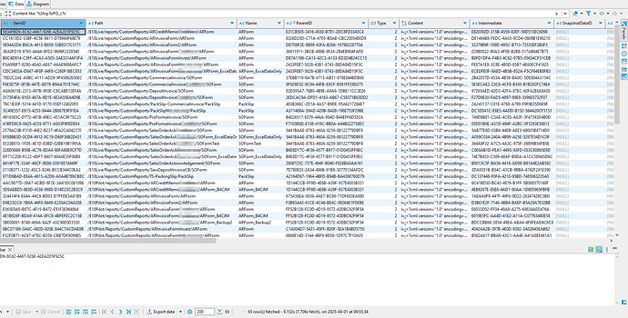

select CONVERT(nvarchar(max), CONVERT(xml, Content)), * from ReportServer.dbo.Catalog where CONVERT(nvarchar(max), CONVERT(xml, Content)) like ‘%_c%’
I was able to use this to convert it to readable text. However, the only ‘_c’ in the xml for the report in question were Lbl_Calc Lbl_Company Lbl_Contract fields.
Doing the where clause with the custom field in question ‘%MassAllocate_c%’ netted 0 results against the entire table.
