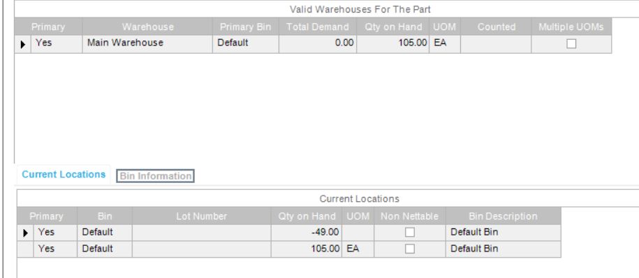

Hello,
I have a few parts with quantities with no UOM. How do I remove those parts?

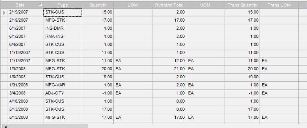

Purchase Advisor:
Transaction History:

How do you go about adding “the UOM to the parts”? I can’t do a quantity adjustment or use the DMT because both require a UOM.

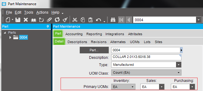

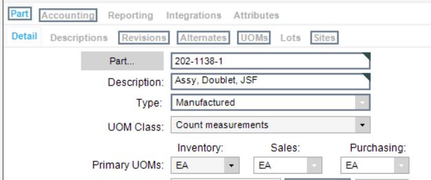

There are a few ways to do this:
In Part Maintenance you can change them one by one:

I do not see where I can change it because it is already EA for all of the UOMs.
I am familiar with the DMT tool but I am not sure which table to update to get rid of the line with a blank UOM.

If you’re familiar enough with uBAQs, you can create one that has a selection criteria against PartTran where the UOM is an empty screen and simply update all records with EA. I was able to use this method to update a transaction that somehow had a blank part number.
