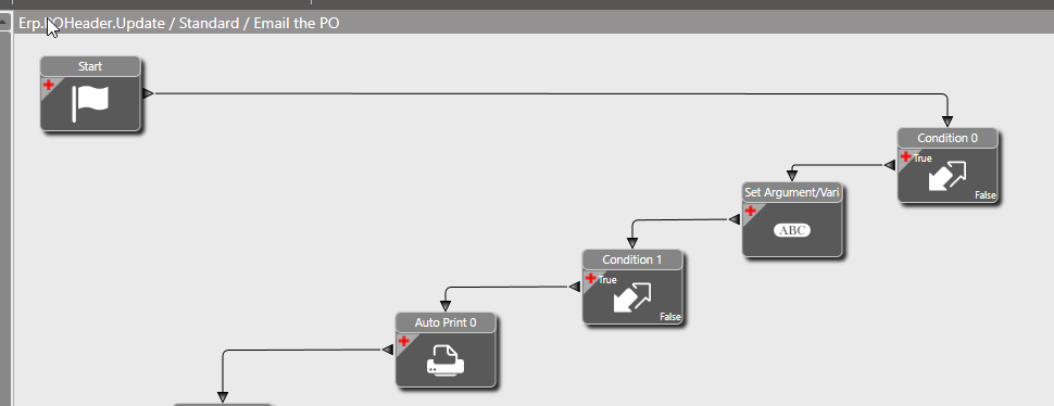

If the Auto print action fails, how can I retry? Its successfully submitting to the task agent, so its not the bpm that is failing. Its the print task itself that is failing intermittently. I understand it is no longer possible to hook a data directive to systask (in cloud anyway). Any other ideas on how to get some kind of retry action in place?
Right now I am monitoring the failures with automation studio, which then emails me to tell me that it failed. But that is on a schedule and then I have to manually deal with it. The failures are server errors nothing wrong with the data or the report.

Our autoprint is triggered from something in the background like a checkbox. This way if we need to, you can recheck the box to kick it off again.
