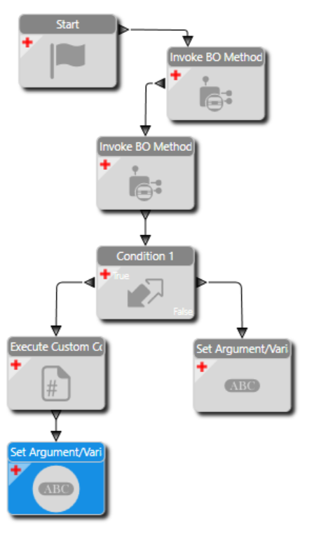

Full efx. First widget is Erp.JobEntry.GetByID. Second widget is Erp.SalesOrder.GetByID. Condition checks the Customer ID. Then my Custom Code from above. The last two are success and failure for REST call.

Disconnect the custom code block and see if it still errors out.

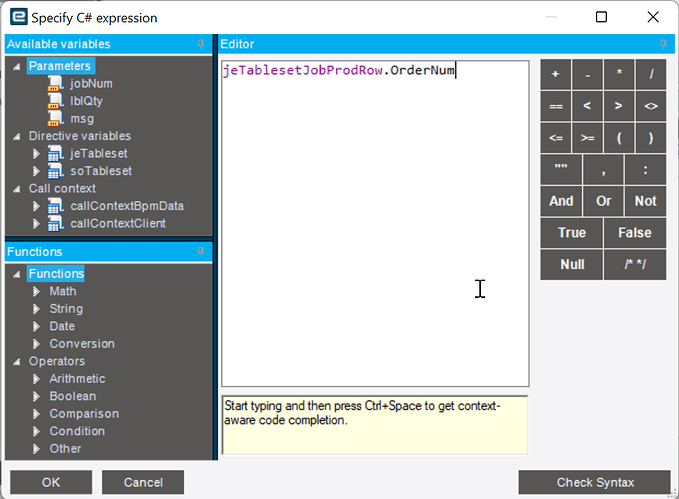

Shoot, it is the widget causing the error. Here I thought it was my code. Is there a way to return a single in an expression?

The expression only has to be valid C#. You can do a linq with FirstOrDefault from Db or your tableset
Can you avoid the linq and just use a BAQ and the DynamicQuery business object?
