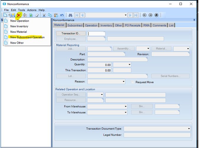

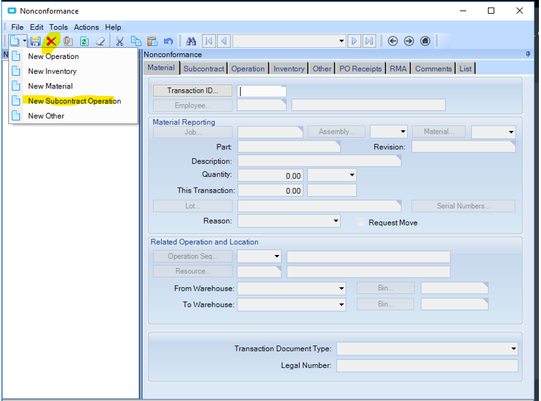

When creating a Nonconformance for a Job’s Subcontract Operation, the system will automatically subtract QtyCompleted from the Subcontract Operation. After that, I have not processed the Nonconformance(NonConf) but deleted it right at the Nonconformance screen. The system will automatically delete the Nonconformance and PartTran. TranType is: SUB-INS and TranDocTypeID is: NCF of this Nonconformance and automatically creates Erp.PartWIP with TrackType of R but has not returned the QtyCompleted number to JobOper

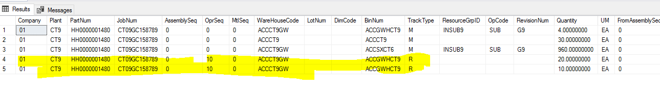

select * from erp.PartWip where PartNum='HH0000001480' and JobNum='CT09GC158789' order by TrackType

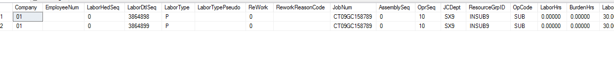

LaborDtl:
