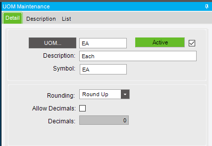

This will do it.
So simple!! Thank you!
hmmmm…quick question. Will this also round up at the routing level? If one part takes .25 of a sheet (an EA), then I dont want to round up to one sheet there on the BOM. I only want to round up on the job QTY if there is a fraction of a sheet left over.
Not sure what you are asking. We use this setting to make sure that we always issue a full sheet to a job. If the job only takes .25, the router and everything stays the same, it just rounds up the material needed.
