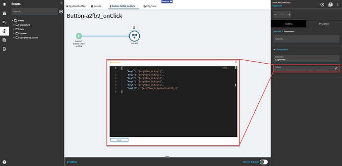

Use the row-add widget.
"NewViewCol1": "{SelectedView.ColName1}",
"NewViewCol2": "{SelectedView.ColName2}",
"NewViewCol3": "{SelectedView.ColName3}",
"NewViewCol4": "{SelectedView.ColName4}",
"NewViewCol5": "{SelectedView.ColName5}"

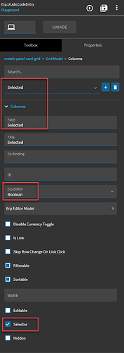

Or, if you’re looking to add multiple selections at once, you’ll need to work with the dataview-condition widget to iterate through.
- Set your grid model to be “Selectable”
- Add a new column to be the selector
- Create a no trigger add-row event
- Call that event on your dataview-condition where YourView.Selected is true
