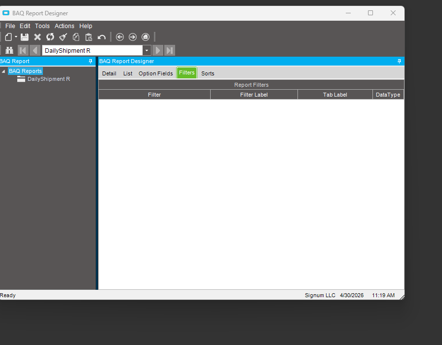

I created a Daily schedule through System Agent
I used the BAQ report designer to set list and option fields.
I do not see anywhere were I can extract it via Excel and then get it emailed to any email I’d like. What am I missing and is there an easier way to do this?

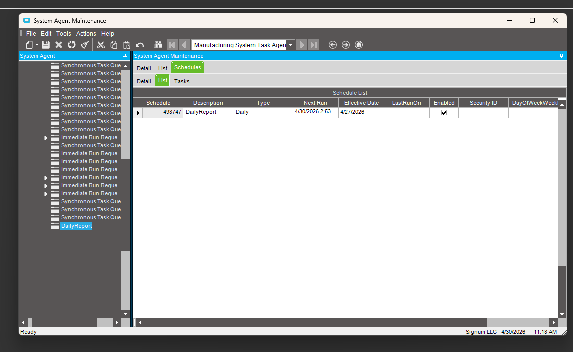

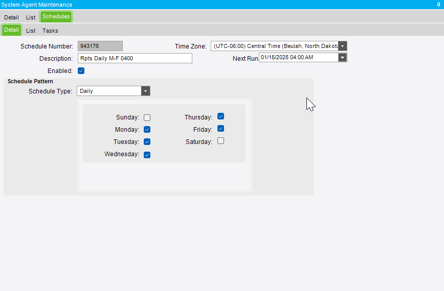

Setup System Agent with a task if you don’t already have one that’ll meet your needs:

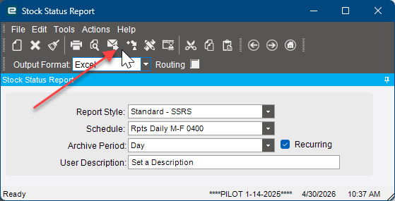

Then when you go to print the BAQ Report, set the Schedule, mark Recurring, set an Archive period, enter a Description (optional but suggested), set the Output Format, and Click on the Email then setup the email template:
Thank you Randy, very helpful, but how do I pick my Daily Shipping Report from the stock status report screen? I can only see parts/warehouse report options, not shipping.
I was just using an example print form, you’ll have to use your actual print form as I don’t have your report.

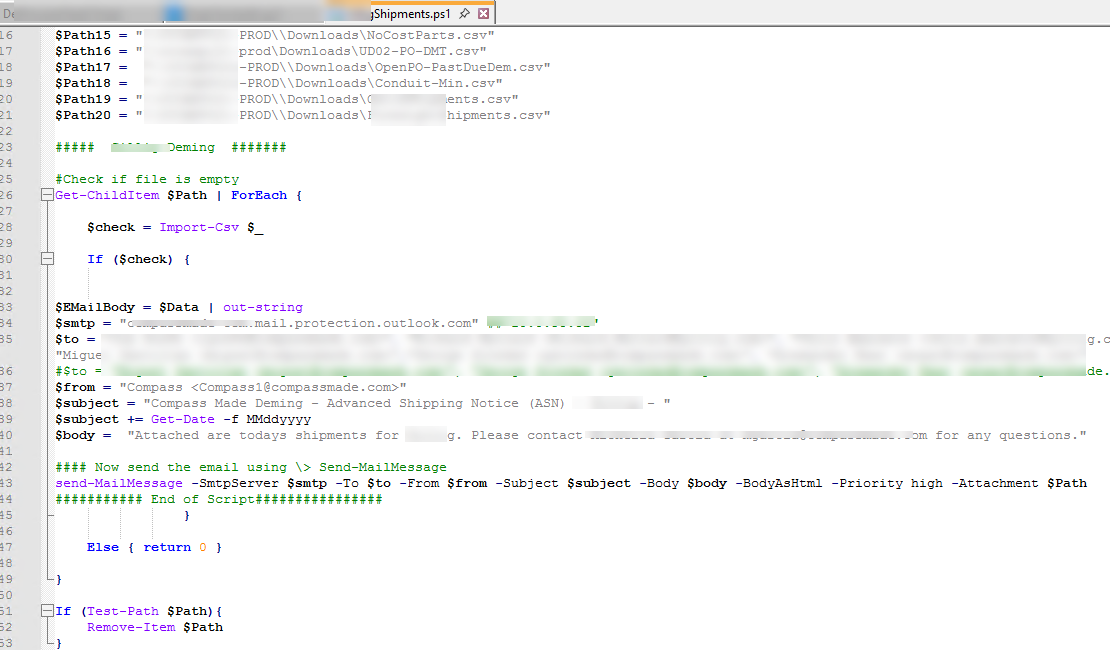

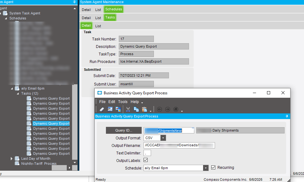

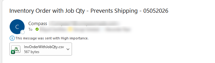

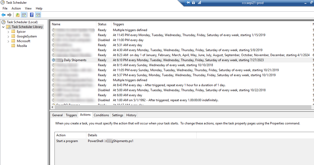

I am no programmer, but I did it by creating the query, using the BAQ Export process on a task and saved it on the server.

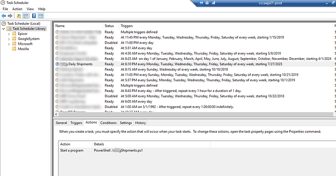

Then on the server, I have a powershell script that is triggered by Windows Task Scheduler Manager. Works for me
Nice Randy!
There are many ways to do it and yours is certainly one of them. The only concern I’d have with that is there’s no way to get Epicor support to step in and help the end user if you’re not there.
If a user brings up to Epicor support that they didn’t receive their daily report, they won’t know where to look. If you would have published a BAQ report or a Report linked to your BAQ as an RDD with parameters, you could have scheduled it natively within Epicor as Randy had mentioned and if it errored out, Epicor support would have a better idea of what happened because you built it all within the Epicor ecosystem whereas you leveraged windows task scheduler to run ps code- which is still something Epicor supports, but much harder for them to troubleshoot if it ends up being something windows/server related that prevented the task from running.
