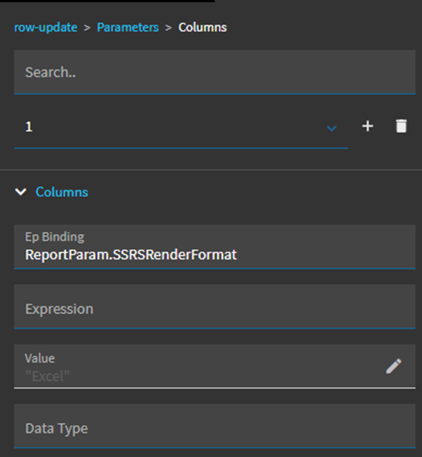

Here is one of mine. Seems like you only have remove defaults for some reason which is really strange.
I found that the standard app layer that the baq report builds comes with a data rule to disable. not sure why.
I can’t imagine why
Where did you put the Row Update?
Normally I add an Event and trigger it after an Initialize or similar type Event
Thank you. That works.
