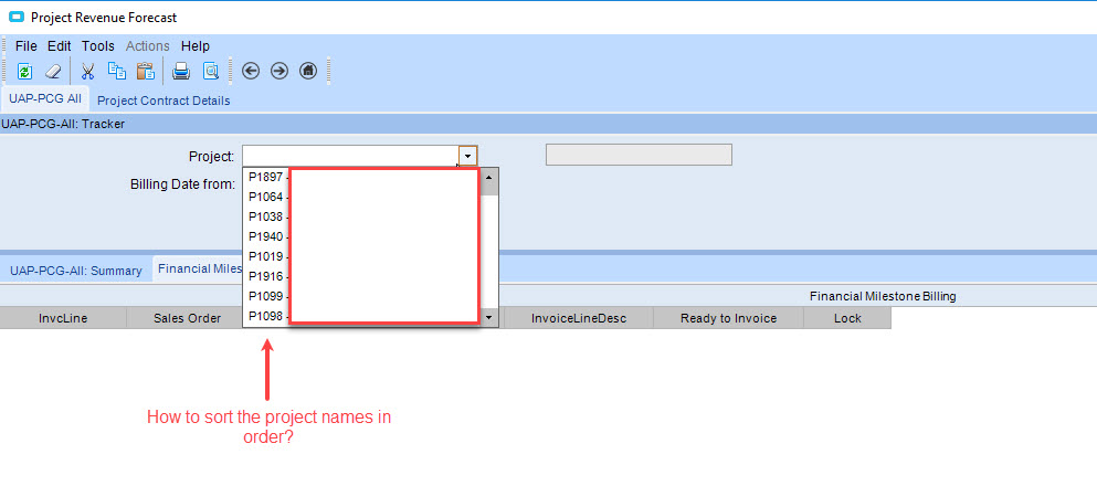

Hi,
We have a customized dashboard where we can see information on financial milestones of different projects. There is drop-down menu from where we can select a particular project to check certain financial information. A BAQ pulls the data out from the back end when a project is selected from the drop-down list, which means the project ID is the parameter in the dashboard.
However, in the project drop-down menu, the projects do not come as an order. So, I want to know how can I sort the project ID (parameter) under the drop-down menu?
I have attached a screenshot here-
Thanks!

Have you tried sorting the BAQ that is pulling the values?
There is also a Sort option on the Properties tab in Customization mode. You can select the column to sort the dropdown items by.
Hi @jkane
Yes I tried in the BAQ but it does not reflect in the dashboard.
Hi @tsmith
Thanks for your suggestion. I will try the option and check whether that works. Epiccare has suggested me to try out Episort function, but I have no idea how to implement the function, possibly via C# code.
