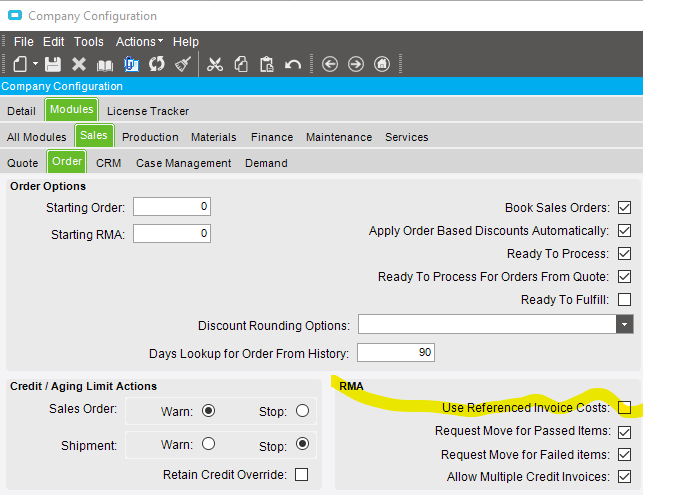

I had the same issue… after looking for way to long due to poor error messages and shockingly bad labeling I found it under:
Company Configuration>Module>Sales>Order
There is an RMA section where you can uncheck “Use Referenced Invoice Costs”
