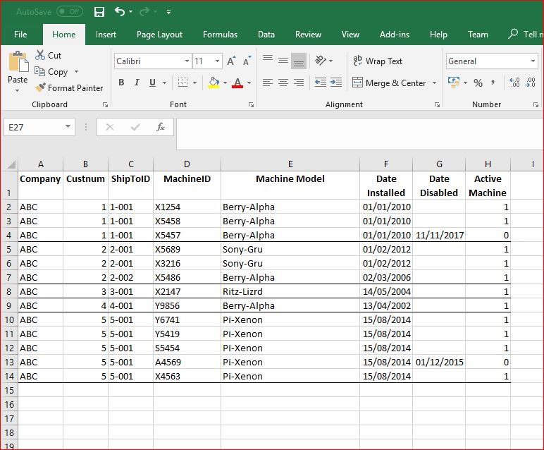

Hoping to achieve a report which will displaysimilarly to this example:
i do not know why not using UD table and create a record for each MachineID, and have more control and visibility of all relevant data, however if you want to do it this way you need to add MachineID to your primary key and this is what you missing.

A UD table is the way to go. Have all the fields you mentioned above, with the first 5 columns of your sample spreadsheet, as keys 1 through 5.
Then you can search/report this data based on Key2 (CustNum) and Key3(ShipToID).
