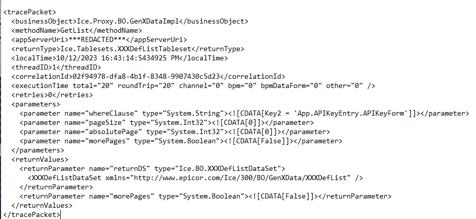

There is a Business Object named GenXData.
The GetList method fires every time someone opens a menu item for the first time during their session.
You can (with some parsing of the text in the where clause), glean exactly what menu item they opened.
This is the method we use to track this kind of thing. We write the where clause and the who/when/etc to a UD table.

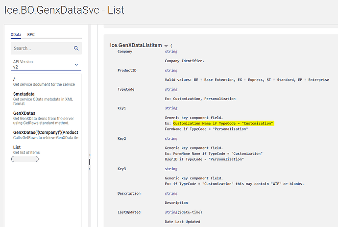

Is there a way to capture which customization is used? We have a few menus based on a UD menu. Just wondering if we can break those up.
If it’s not already in that BO data, you could query the menu table and get the customization assigned to the menu id.
The way I read this, yes.

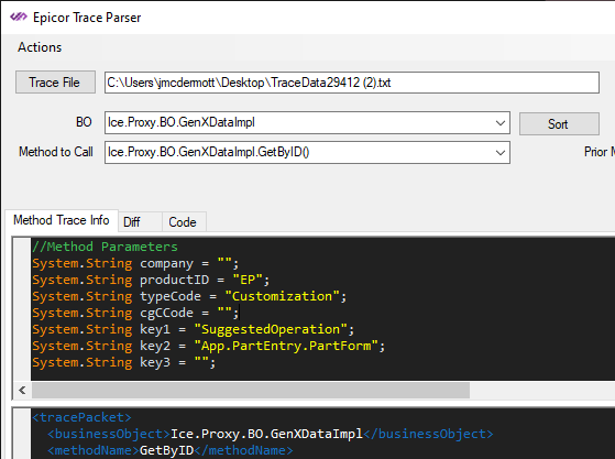

When I do a trace there’s GetList to grab all customizations and personalizations.
And seems like some of the time it will do a further GetByID or two if I have one or both of those (pic below).
If there are none, then it still does GetList; it’s just empty:
