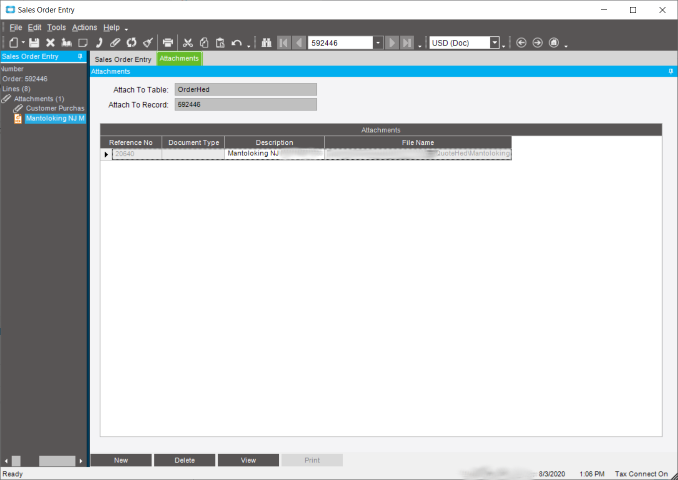

How would I track who adds/deletes attachments in Sales Orders?

When I am talking about attachments, I mean something like clicking on the paper clip at the top in order entry and clicking the new attachment button.
