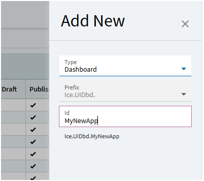

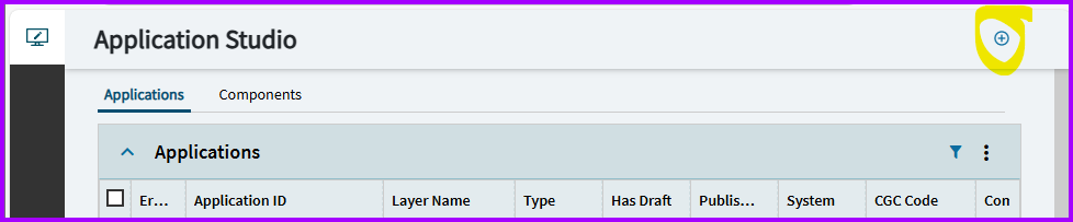

Do you have this in App Studio? (I mean the actual app called “Application Studio.”)
Otherwise, you certainly could start with a pointless classic dashboard, then convert, then delete everything out of it, right? Then start fresh-ish.
