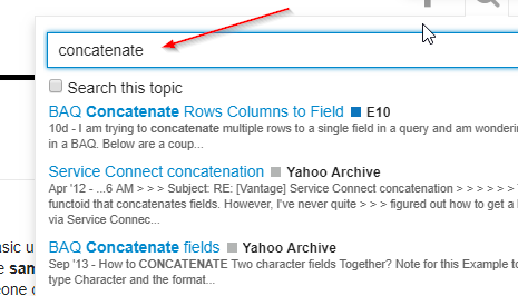

There is already a long winded example of how to do this in the forum that I wrote a few months back. Including a downloadable sample (seach box top right should help) :slight_smile:
