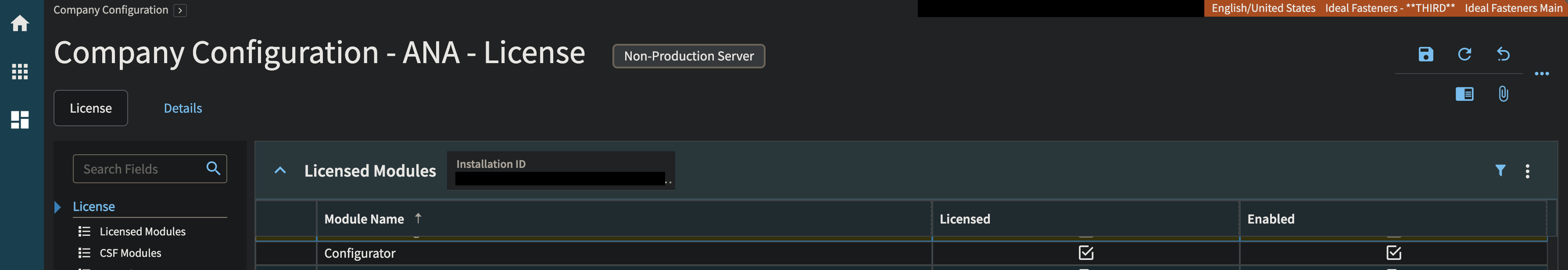

I was wondering about a configurator, but I don’t think we have it. How would I find out? Is the “embedded” one different than another one?

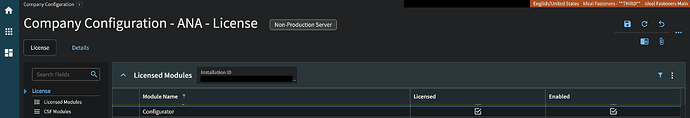

You can find what you are licensed for in Company Configuration → Modules → Licenses
The Embedded Configurator is the one that is native to Kinetic, there is another configurator (CPQ) which is a separate product entirely.
