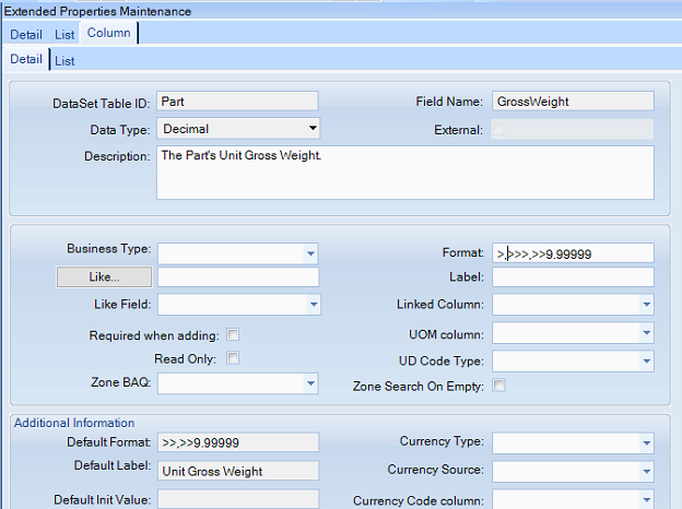

At Part entry → Attributes → Weight/Volume Unit Gross Weight
I need to write like 112,520 Unit Lbs.
But I can only write 11252
I don’t know why. It is not very very important, but we used to put the weight in lbs too
Please, help

In Extended Property Maintenance. Enter the Part table and go to columns and set GrossWeight like below with as many > and , as you need. Save and they are in effect when you reopen Part Entry.
