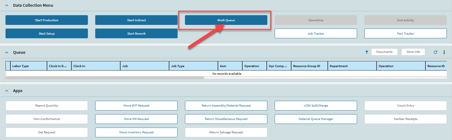

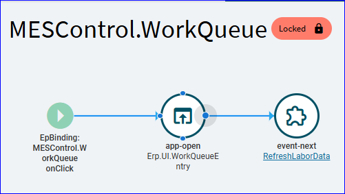

If you look at the MES form in App Studio and that particular button… click on Behavior > OnClick… it’ll open the on-click event that opens the Work Queue Entry form.

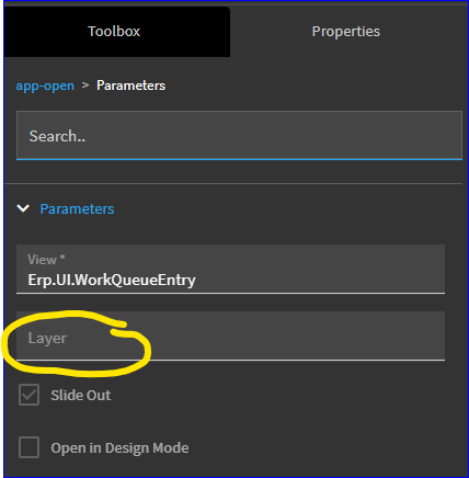

The Properties of the App-Open portion of that event is the issue:
It is opening the BASE form… with no Layers applied! So, you customized WorkQueueEntry, and published it… but this button/event is not calling that layer to be applied.
The PROBLEM here is, its a base event and you can’t change the properties.
So, you have to ALSO customize the MES form so you can customize how MES behaves.
Depending on your version, the easiest thing to do is copy the base event. Then repoint the trigger to override the base event. Then you can add your layer name in the app-open properties and you should be good.

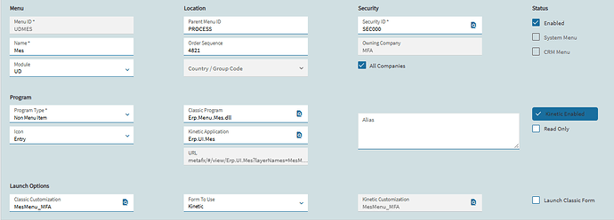

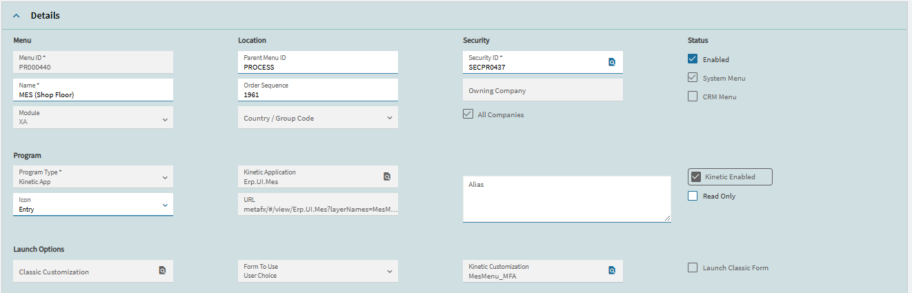

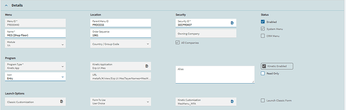

I added my mes menu customization to the process menu like you sad and in there I have the event the overrides the event for the work, but when I go to my mes url It is not showing up. When I go preview my mes customization I see the columns that I added to the que grid. Am I missing something?

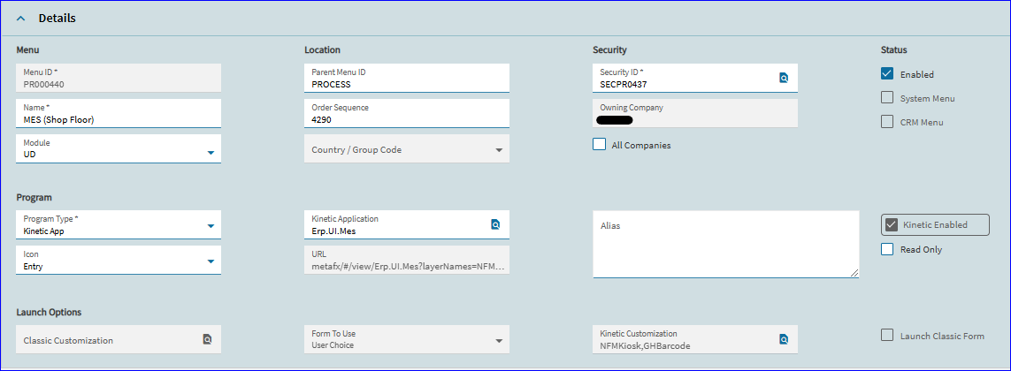

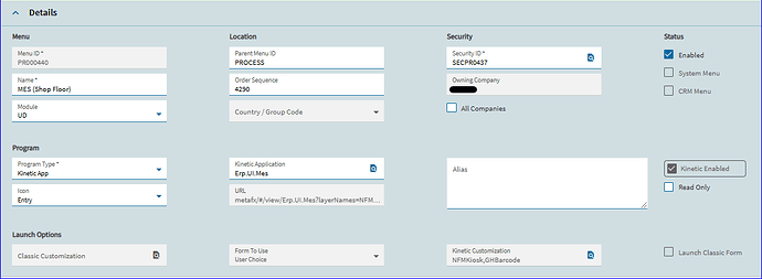

That image is still showing as a System Menu. Did you copy the menu to your current company?
I’d expect the Module to be “UD”.

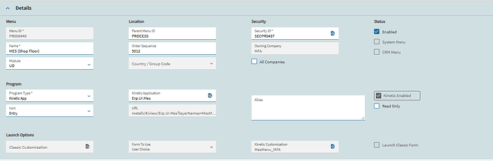

I do have a UD one the I made but the URL says it pointed to the other one.

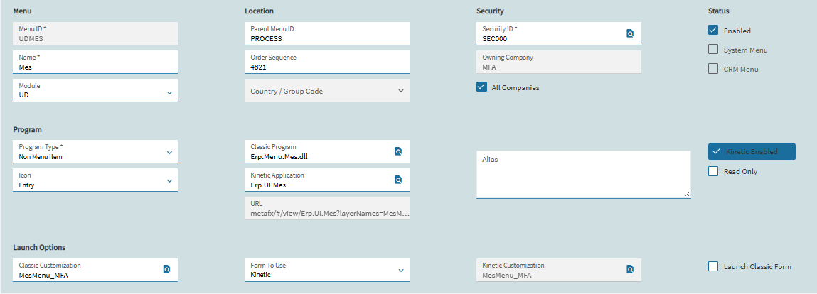

This is what mine looks like:
I did a copy to current company, but it still doesn’t show.
