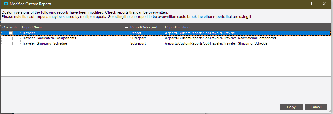

I’m working on a custom job traveler in the pilot. I made a copy of a report style, and I am going to make some changes to it. I get this message:
Does that mean I can’t have multiple versions of the sub-report? I don’t want my changes to affect existing report styles.

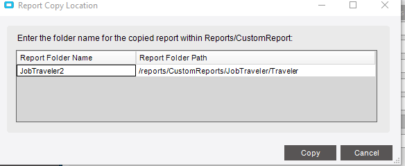

Hey Evan, try changing the “Report Name” column to be different that the standard one (Traveler2 for example). It can take several clicks to get the text to highlight and get it to change though. This should also update the report location (which is the main issue, 2 files same name same location).
this is the screen you’re looking for , comes up right after copy report style. Changing the report folder name can be finicky.
Oh, I was convinced that was unchangeable as no amount of clicking was letting me change it. I used F2 just now to begin the edit process and it worked. Thats very strange. Thanks for the help man.
Good to know the F2 trick! Glad you got it working.
